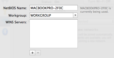

In the Network > Advanced > WINS , there is a NetBIOS that I was not familiar with:

In the com.apple.smb.server.plist is the NetBIOS Name entry:
I deleted the SMB files, rebooted and it made no difference.
I'm wondering how these files end up in the directory.

I think it has something to do with the NetBIOS name. At some point this machine was configured to connect to a corporate network and somehow it still thinks it needs to do that. But I can't figure out how to undo it.
Does the info come from a boot ROM? Is that possible to restore?
So, try changing the NetBIOS name.
It's one of the network config names that I often will change on a new setup. So, computer name, and the local hostname (both in the Sharing pref pane), and the Network/Advanced/WINS NetBIOS names are related, but I change the default names so if some network issue comes up, I know for sure which of my Macs is the source.

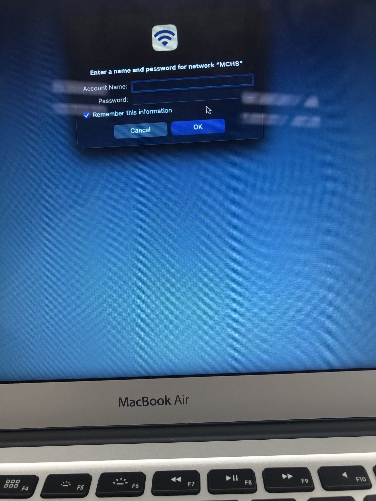

Hello there, my brother gave my son his 2012 macbook for school. We did a factory reset, he was able to login to home wifi network, but he can't log in to his school network. It asks for account name and password. He used his info but that's not it, he used my brothers old one and that's not it either. Any help would be greatly appreciated.
He probably needs a username and password from the school administrator.
the school administrator has also provided attempted to do this and no other kid has issues with logging in to the school wifi but his computer is still asking for the same things -account name and password.

Does the network use MAC filtering?
I agree... It's likely that the school needs to add the Macbook to the school network. That's probably why the password doesn't work yet. You will need to contact tech support at the school. They will likely need the hardware MAC address to do that.
I am hoping that will do it, all the other kids who have MACs didn't have to do this, is there something additional i need to let the tech support at school to try, so they can resolve? I just don't understand why all the other kids who have a MAC laptop didn't have any issues connecting to schools wifi.

I don't think there's anything left to try unless the school needs a particular version of macOS.
Do the other students have the same model MacBook?
Did the other students supply their own Macbook - or did they get a Macbook through the school (supplied and set up by the school)?
Hi there so my son got home today, and other kids have different versions of Macs, chrime etc. these are all brought in by kids. none supplied by school. School tech guy wasn't sure what the issue was so he couldn't connect him to the schools internet. I can't afford a new computer now any other suggestions?
