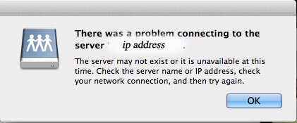

Constantly get the error:
"There was a problem connecting to the server "hp-pc".
This file server is available on your computer. Access the volumes and files locally.

Nope. Same thing. I get this same error message:
As I try to "Connect to Server" on my Mac. occasionally, it asks me if I want to enter as a guest or enter a password, either way nothing ever works.

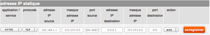

I only managed to do it now. Port forwarding was hard to figure out on this router, dang...check it out, it's in French but all the same words as in English:
The info you see is the default stuff in grey. When I created a new condition in my router firewall, I wrote everything as this is, with only 139 at the end in stead of the '443'. Like this:
And then I tried connecting, and still got the same error message.
But now that I think about it, it's less a problem with the Mac and more with accessing the HOMEGROUP at all, as I tried from my WD TV Live device, and couldn't access files from the PC from there either...so it must be the medium of communication, i.e. the router. So I think we're on the right track.
Could you just tell me if that last pic I posted seems sound to you in the parameters for the 139 TCP port ?
