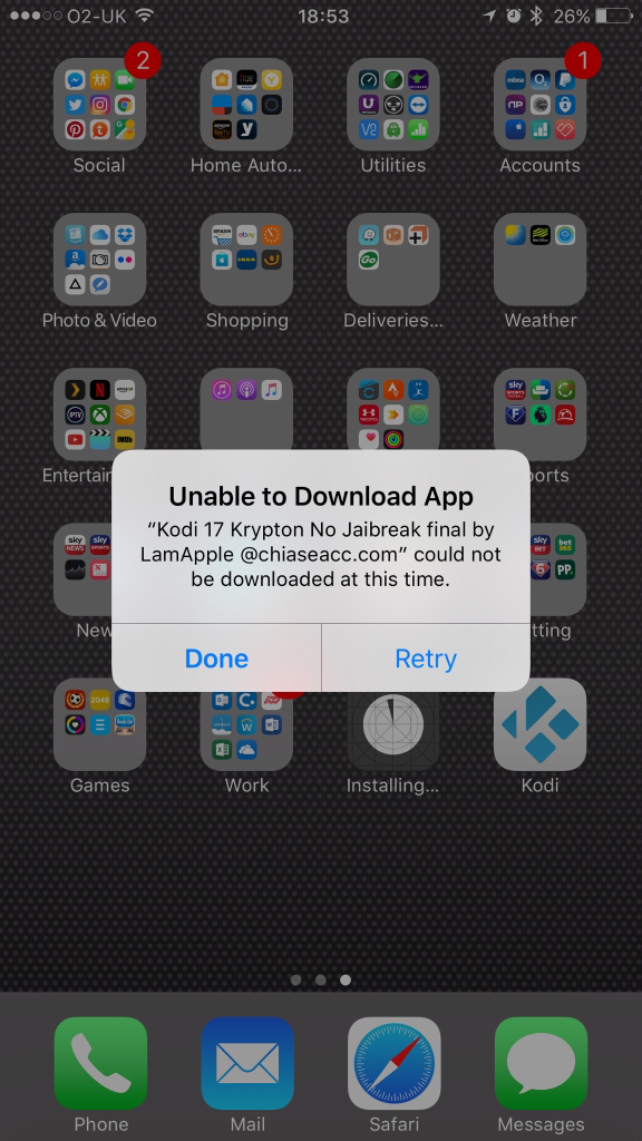

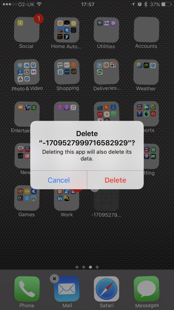

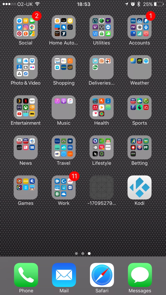

As per the picture, I can't delete this app that failed to install on my iP7p
Any suggestions, I've tried a few things I've found online but to no avail.
Do a backup, wipe, and restore from backup?
I don't believe this "app" would remain on your device after that.
It doesn't show in the storage settings as it never got fully installed.
I don't really want to go through a full wipe and restore if I have to - any other suggestions.
I've also connected it to iTunes and I can't delete it from there.
Signing out of the App store does nothing and neither does rebooting the phone.
So it does install Kodi but then I can't do anything with this other "app" no matter what I try
It's Kodi, following the news found here I thought I would give it a go.
http://koditips.com/install-kodi-on-iphone-without-jailbreak/
I decided I didn't want it after all, and I can delete the Kodi app fine it's just this mess is left behind!

Looks like it's going to be a full restore job. I'm part of the public Beta program and on what ever is the latest 10.3 iOS. Am I going to be able to factory reset and restore from a backup made on this iOS version?
There are only a few things I can suggest:
  • Reinstall the app and make sure it finishes installing, then uninstall it
  • Reset Home screen layout
  • Restore from a recent backup without the app installation
  • Full restore/reset

This type of error is very common on beta versions of iOS. Happens to a lot of other sideloaded apps.
There is no solution besides full restore OR waiting for next beta3.
Updating your device to iOS 10.3 beta3 (when it comes out) should remove that faulty installation.
This happened to some people on beta1 and was cleared once they updated to beta2 so I expect the same will happen with beta3.
I had this happen with a beta version of my bank's app when it incompletely installed last week. The "bad" version is sitting right next to the properly installed version. Glad to hear next beta should resolve this.
