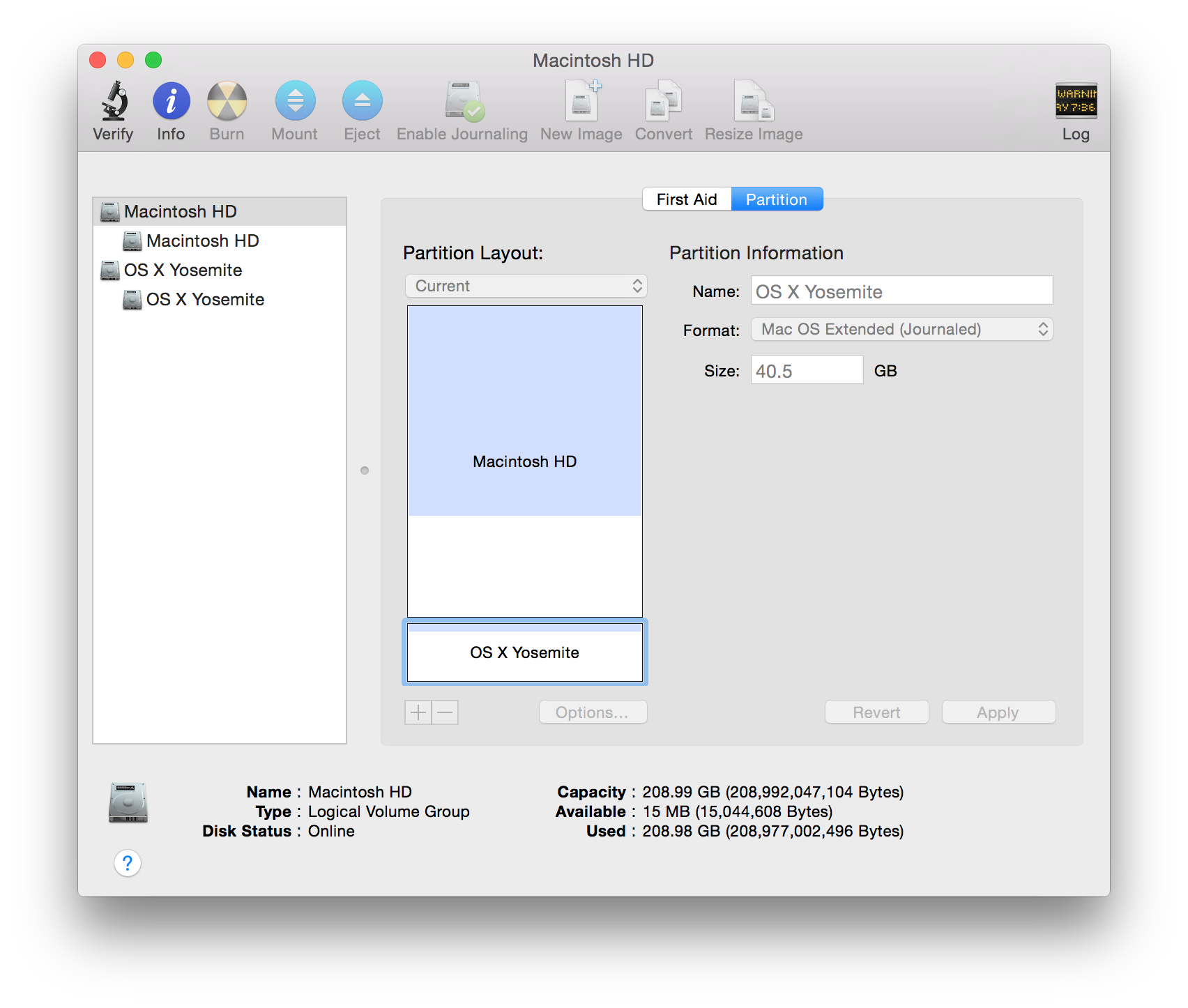

I created a partition when I was running OS X Yosemite beta. Now I can't seem to delete or resize the partitions.
Anyone know what I can do to delete it? I've tried erasing it and repairing the disk. Neither has helped. I've attached a screenshot.

Likely its been changed to Core Storage as part of the Yosemite install, you will need to run a couple of terminal commands to remove the CS Logical Groups and Volumes before DU can re-partition/erase etc.
I don't have the commands to hand but I'm sure a search on here will find them...
