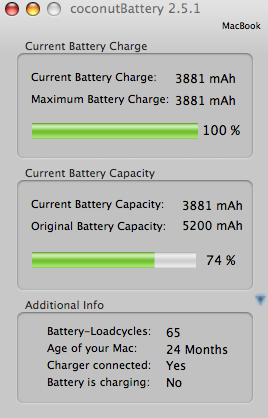

Thought I'd kill 2 birds with one stone ,I'm also having a few issues with my battery, coconut battery says:
Is that normal? Because my Macbook turns itself off instead of going to sleep, even if it says there is still about an hour or so left. Is my battery shot? Could I get it replaced on applecare? (I still have warranty left from applecare I purchased).

2. Coconut Battery readout looks normal. Your mac is 2 years old and the capacity of the battery will decrease over time. You can re-calibrate it and it may increase the capacity.
http://support.apple.com/kb/index?page=search&q=battery recalibrate
Since you didn't mention which mac you have, I provided the link to the main recalibrate page. Just select the link which best supports your mac.
