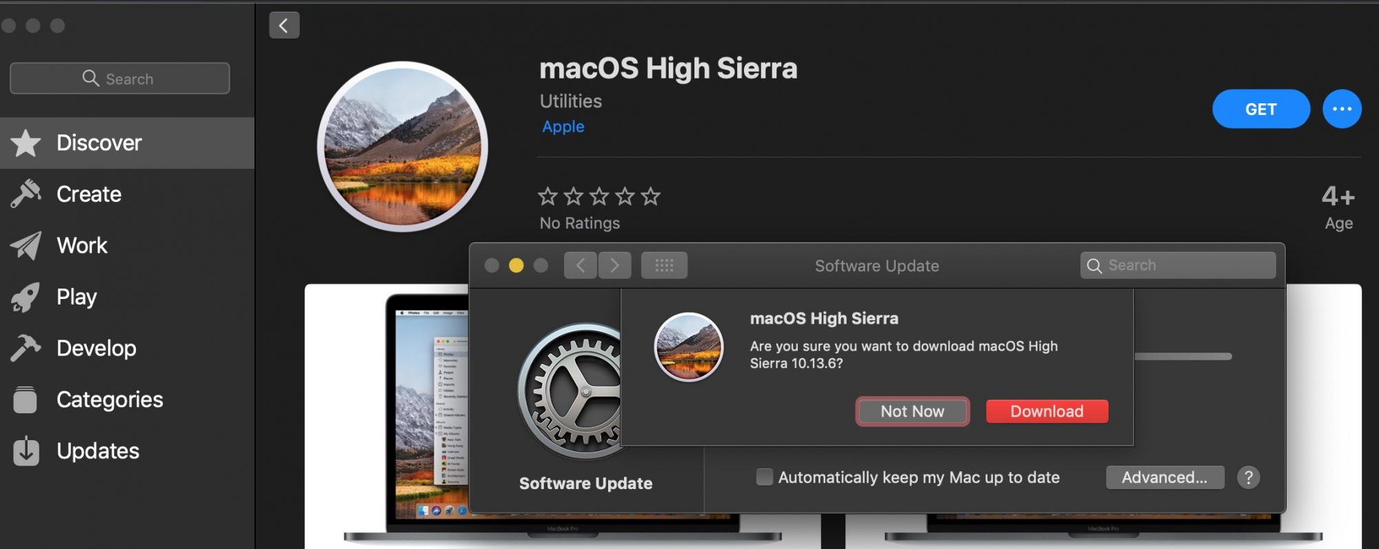

There is nothing in your first post that indicates you tried the links that Apple provided in my post.
I am also running Mojave on one of my Macs. Just now as test I tried the link and here are the processes I saw:
I clicked "GET" then Software Update" opened and then I clicked the Download button.

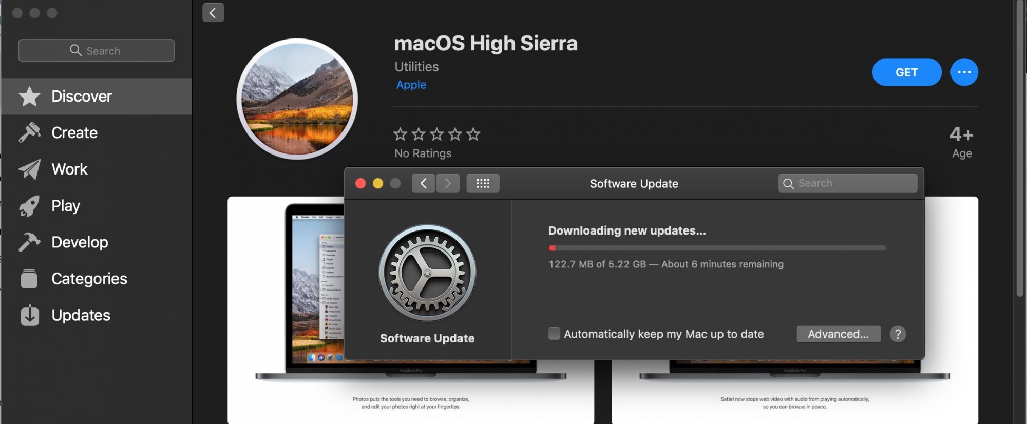

The download started.

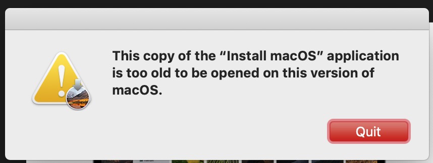

At the end of the download I get this pop up because I'm running Mojave and the High Sierra installer app can't automatically launch.
I click Quit.

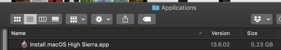

The entire High Sierra installer app is in the Applications folder available to be used for creating a USB installer or saved/moved to another location.
Maybe you need to try a couple of PRAM resets and try again.

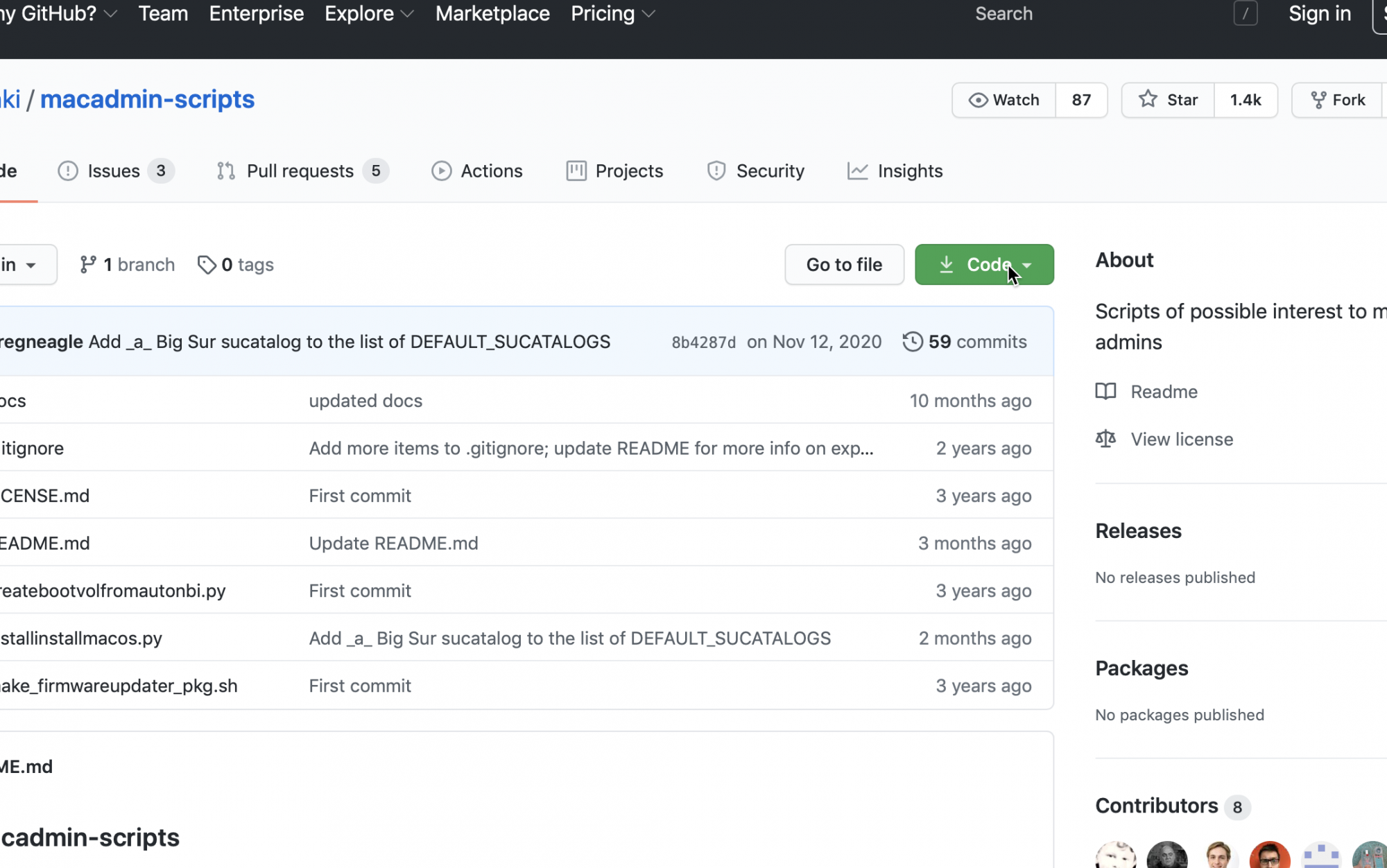

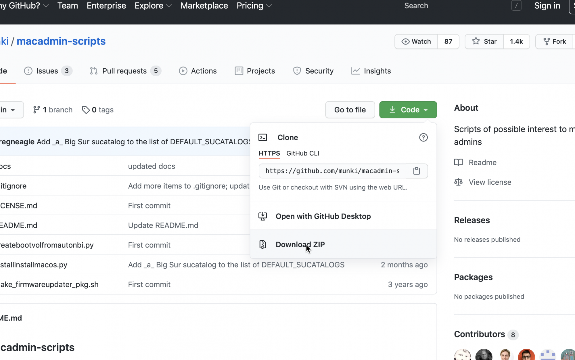

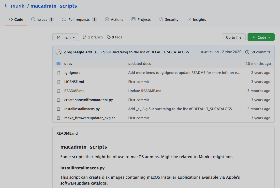

And you can't download HS installer ?
If so then read below, I made this note in my 'Notes' App so that it may help me later, I just copied and paste here.
Download any macOS without using App Store:
First download this:
Then Move the script ‘installinstallmacos.py’, not the entire macadamin-scripts folder to /Users/Shared and then run the following in Terminal:
Code:
sudo /Users/Shared/installinstallmacos.py --catalogurl https://swscan.apple.com/content/ca...n-lion-snowleopard-leopard.merged-1.sucatalog
Then insert the number correspond to the macOS you want.
It will download the installer from Terminal.
And then you have to make it Bootable.
You may find 13.0 there.

Uhm...thanks Bo, only I'm afraid it's beyond my skills.
What should I exactly download here?

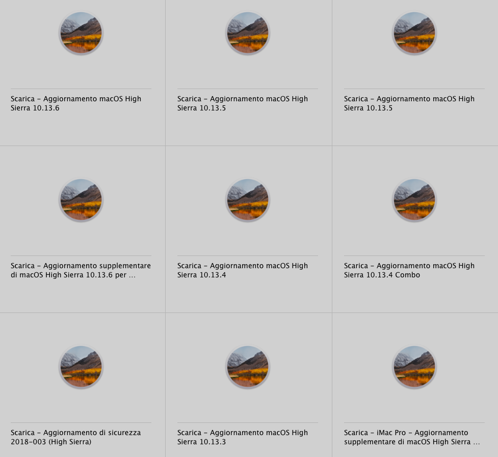

I'm sure. You need the full "Install macOS High Sierra" app (about 6 GB) to make a bootable USB installer.
Not sure to understand; in Apple Downloads section only update versions of various OS are available for download, at least for me.
"Aggiornamento" stands for update
Are you saying I can make a bootable installer out of one of those update versions?
