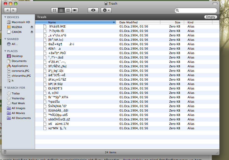

There are mysterious files appear on my trash and I can't empty the trash, but when I say get info for these files they disappears and appear sometime later. What are these files? Please help. Thanks in advance.

If you empty the trash while holding down the alt key it will force empty them. Make sure that you do not need the files!

I did what I've done before. I changed my Startup Disk to an External Drive and rebooted Leopard 10.5. Emptied Trash - 250,000+ files 🙄 - and switch back to Snow Leopard.

Depends on the OS. It's Secure Empty Trash, or something like that, in SL, and I think it should be unchecked. But, look for that from someone who actually has SL!
