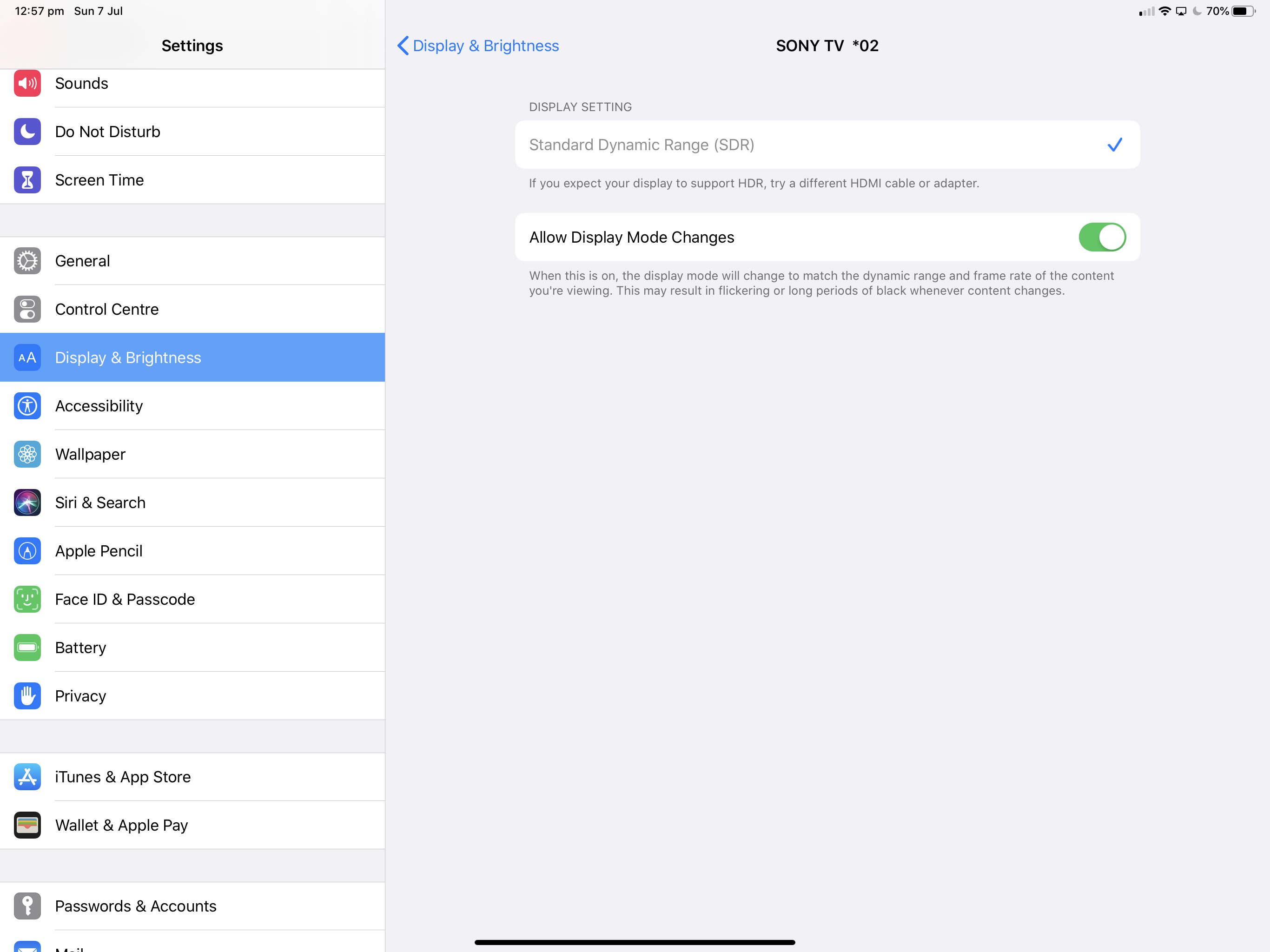

Hi,
I have iPad Pro 2018 and I just purchased Belkin USB-C to HDMI and MS Surface USB-C to Hdmi adapters
Both support 4K HDR, HDCP 2.2 and also I have a few HDMI 2.0 Cable that’s perfect for HDR.
But when I connect to my Sony TV 4K HDR (X8500), on display setting it does not show HDR output for me.
It says that I have to change either cable or adapter to have the HDR function.
I’m pretty much have all the requirements but still can’t use it.
Any suggestions?
PS. My TV shows HDR just fine for PS4 Pro with the same cables

Which HDR setting did you try? The Sony X8500 doesn't support Dolby Vision.
I just want to apply HDR10, just the iPad only shows SDR option for me.

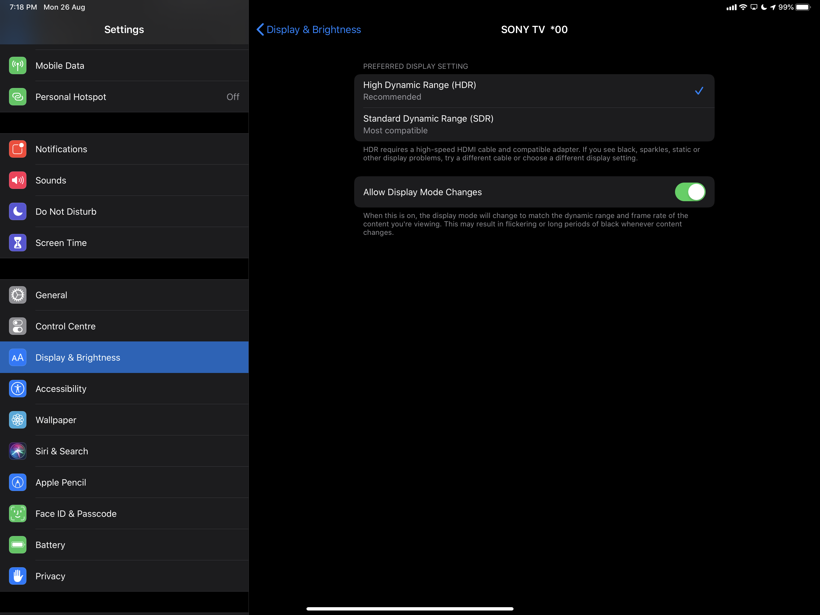

[doublepost=1562605442][/doublepost]Are you running the Beta? IME, the beta broke a lot of existing functionality.
Reactions: EugW
