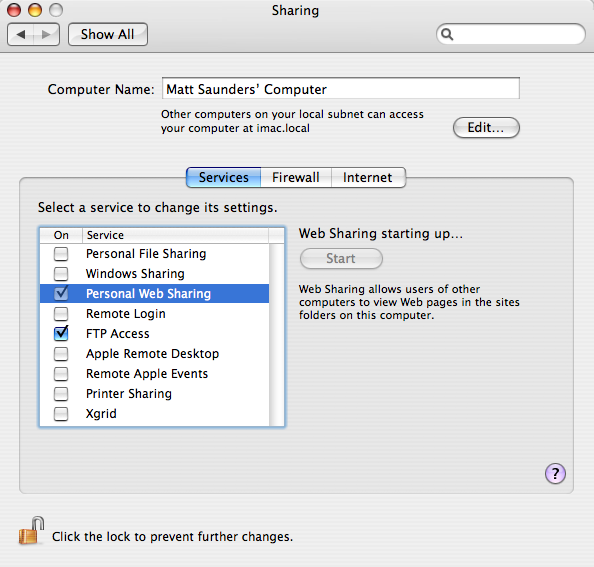

Hi there I am very new to macs so can you reply with full instructions to sort the problem.
When I click on System Preferences > Sharing and Click the box next to Personal Web Sharing it Just says
Web Sharing Starting up.....
And does not do anything.
See screen
Perhaps Apache is having difficulty starting.
Using a web browser, navigate to http://localhost and http://localhost/~<your login name>
If nothing shows up, open Applications/Utilties/Console and stop/start the service again. What do you see being logged?
The Console just displays the system log (I think you're thinking of Terminal). What I meant was, open Console so you can see the logs, then using the Personal Web Sharing preference stop and start the process and see what's logged.
When I stop and start Personal Web Sharing I see:
Code:
/usr/sbin/apachectl stop: httpd stopped
Processing config directory: /private/etc/httpd/users/*.conf
 Processing config file: /private/etc/httpd/users/<my name>.conf
/usr/sbin/apachectl start: httpd started
And did you try accessing http://localhost/~<your account> to see if it works?
I think this is what you want lol
Code:
 Processing config file: /private/etc/httpd/users/mattsaunders.conf
fopen: No such file or directory
httpd: could not open document config file /System/Library/WebObjects/Adaptors/Apache/apache.conf
/usr/sbin/apachectl start: httpd could not be started
i tried http://localhost/~mattsaunders
and it did not work
Ok, so Apache isn't starting. Does /System/Library/WebObjects/Adaptors/Apache/apache.conf exist on your Mac?
