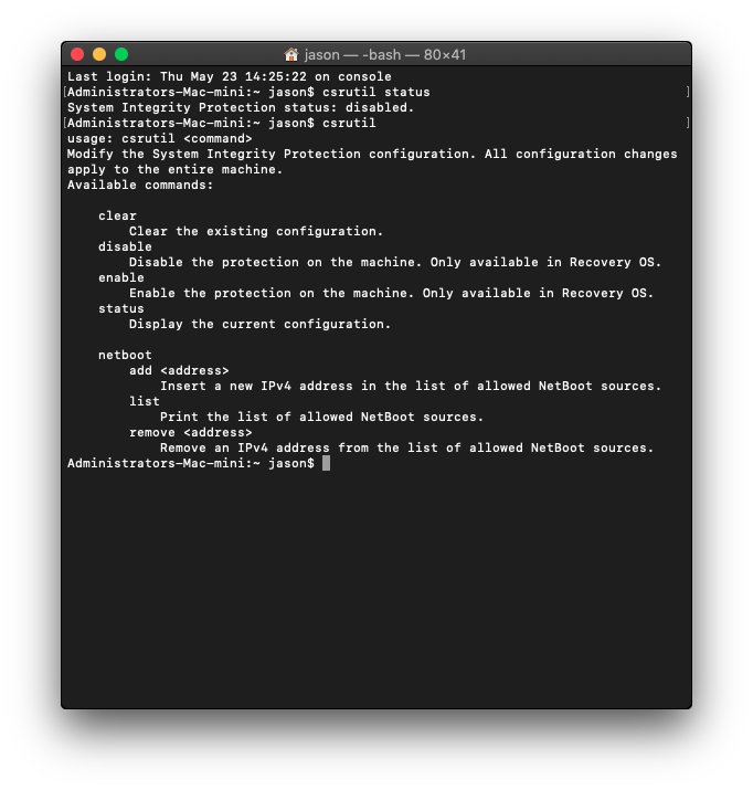

I just found out that SIP in my system (Catalina 10.15.2) is disabled. I tried to enable it in recovery mode (csrutil enable) and after restart SIP is enabled ONLY in recovery mode. I mean command csrutil status shows enabled (Apple internal) in recovery mode, but it shows disabled when I log on normally.
Anybody know what is the problem?
