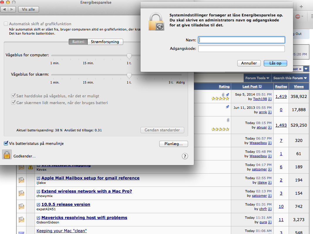

Hello, having this problem that i cant gain administrator access, and i cant make any changes at all.
Here i am ( In danish ) trying to manage my power settings. i click the lock in the left bottom corner, and i get this menu where im asked to enter a name and a password. I dont got a administrator on my computer it appears, how do i deal with that? Login to my current user doesnt work.
Any suggestions?

Follow these steps to make a new admin account, then you can use that account to give your existing account admin rights.
Hold command-s when booting to get to single user mode.
At the command line that comes up type this in then return to mount the drive.
Code:
mount -uw /
Then type this in and hit return. This will cause the new system setup routine to run at the next boot.
Code:
rm /var/db/.AppleSetupDone
Now type reboot and the system will restart. When it starts you will get the new system setup process. Just go through that and setup an admin account. Call it temp or whatever because we will delete it later.
Now login to the new admin account the go to Users & Groups in System Preferences and select you old real account and give it admin rights.
Now reboot and login to you real account. Make sure it has admin right like you want and it if does, go back to User & Groups and delete the temp admin account we made.
