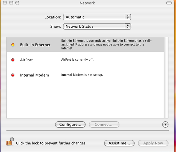

Ok I do not see any of what you are talking about after "Network".
It look like this:

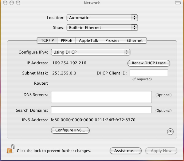

Just double-click on the Built-in Ethernet (in your pic above), go to the IPv4 tab, and set it to "Configure IPv4: Using DHCP"
I'm thee, but it still doesn't work. 🙁

Everything is the same except the Ethernet ID:. Also on the iBook their is no Router #.

Sounds like you need to renew the IP lease on your cable connection. The modem is still "registered" to the iMac. I've had success by turning off the modem, waiting 30 seconds, and turning it back on. Plug in the iBook and you should be good. However, if you want to switch back to the iMac, you'll need to reset the modem.
It's a hassle and the solution is to get a cheap router. The IP lease will be set for the router and the router will issue IP addresses to the iMac and iBook.

Have the ibook all plugged in and set to use internet, automatic connect as mentioned above and set for ethernet. Then, pull the power plug out of the back of the modem. Wait a couple minutes. Plug it back in and then see if the iBook has internet access.

Works! Thanks I unplugged the modem and plugged it back in. 😱
