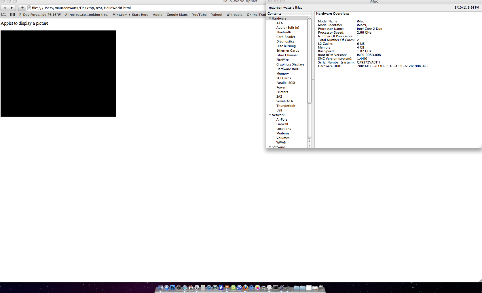

On my mom's iMac the page did appear to laod correctly but all that appeared was a black box.
Screen shot? Which iMac model? Which OS version?

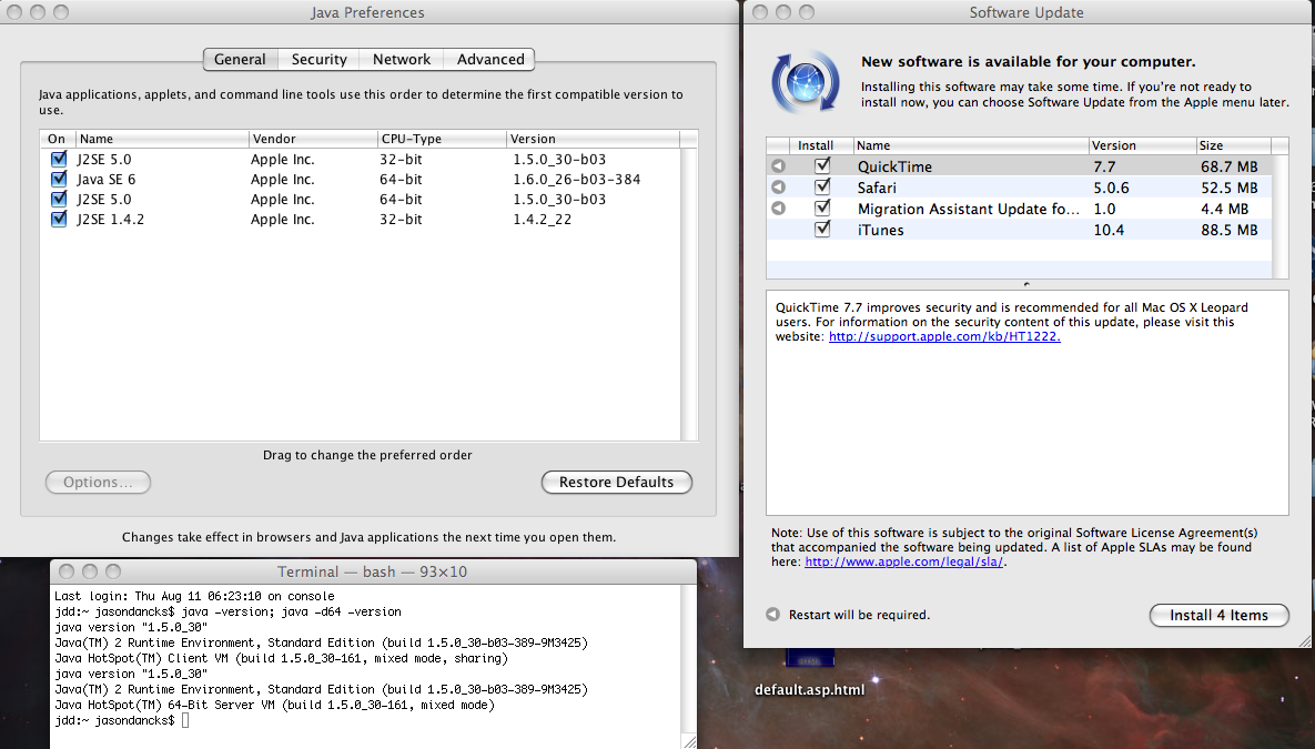

First, identify exactly which version of Leopard you have, on which machine. If it's not 10.5.8, update to that first. If you have a reason not to update to 10.5.8, please explain that reason.
Run the "Java Preferences.app" program, which resides in the Utilities folder. Post what it shows for the available applet and application Java versions, under the General tab.
Next, run Software Update and post the exact list of available updates it shows you. Leave nothing out.
Then run Terminal.app and paste this line into a window:
Code:
java -version;  java -d64 -version
Copy and paste the output and post it.

iMac 10.6.8:
macbook(mine): 10.5.8

downloaded updates 8, 9, 10. 9 didn't need to be installed because a newer version existed apparently.
the result:

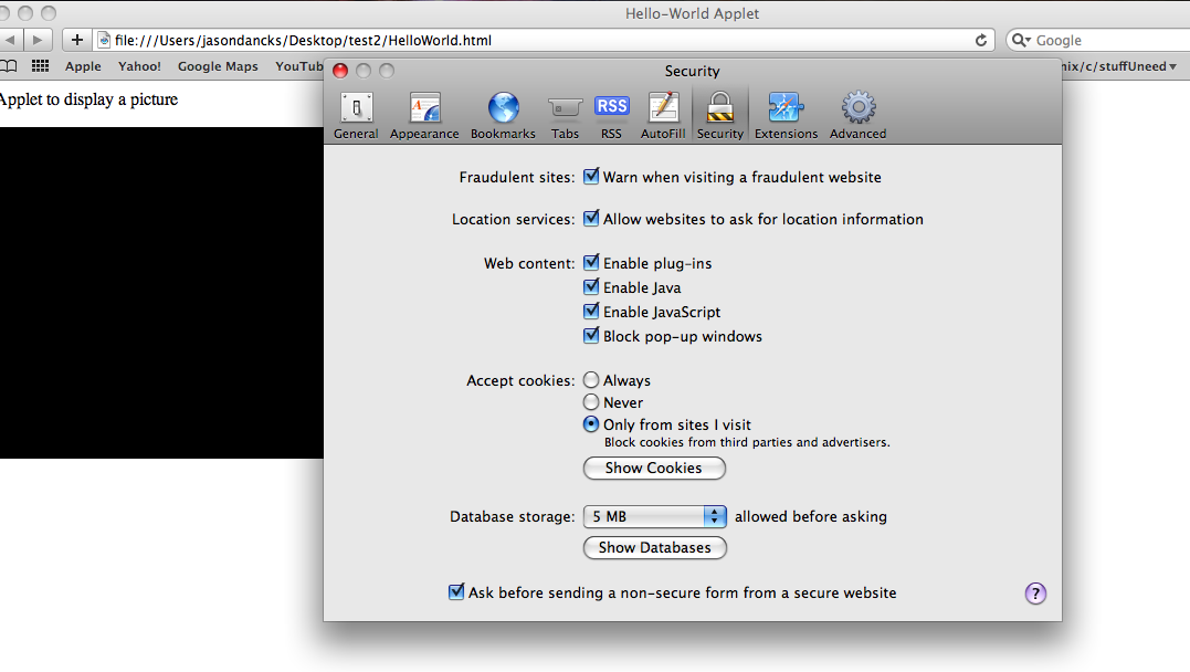

and yes java is enabled for safari:

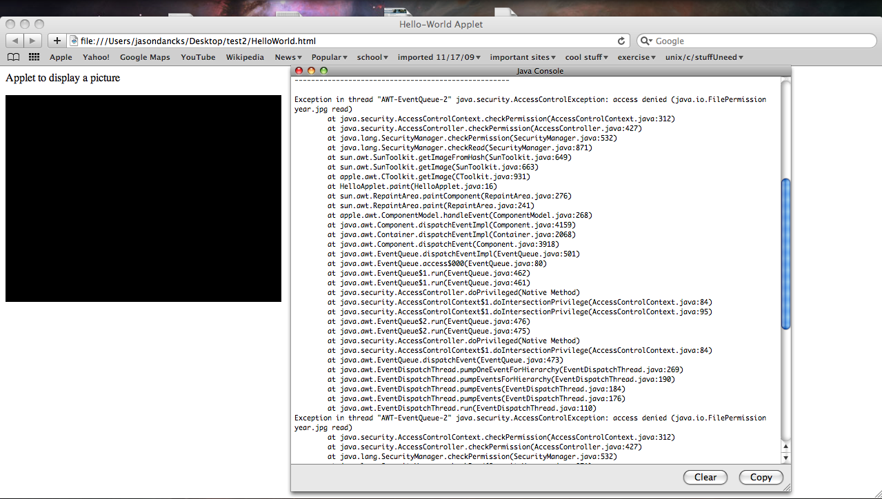

I tried the Media Tracker example you provided. It doesn't work. Here's the java console:
java.lang.UnsupportedClassVersionError: Bad version number in .class file
at java.lang.ClassLoader.defineClass1(Native Method)
at java.lang.ClassLoader.defineClass(ClassLoader.java:676)
at java.security.SecureClassLoader.defineClass(SecureClassLoader.java:124)
at java.net.URLClassLoader.defineClass(URLClassLoader.java:260)
at java.net.URLClassLoader.access$100(URLClassLoader.java:56)
at java.net.URLClassLoader$1.run(URLClassLoader.java:195)
at java.security.AccessController.doPrivileged(Native Method)
at java.net.URLClassLoader.findClass(URLClassLoader.java:188)
at sun.applet.AppletClassLoader.findClass(AppletClassLoader.java:173)
at java.lang.ClassLoader.loadClass(ClassLoader.java:317)
at sun.applet.AppletClassLoader.loadClass(AppletClassLoader.java:145)
at java.lang.ClassLoader.loadClass(ClassLoader.java:252)
at sun.applet.AppletClassLoader.loadCode(AppletClassLoader.java:659)
at sun.applet.AppletPanel.createApplet(AppletPanel.java:786)
at sun.plugin.AppletViewer.createApplet(AppletViewer.java:2389)
at sun.applet.AppletPanel.runLoader(AppletPanel.java:715)
at sun.applet.AppletPanel.run(AppletPanel.java:369)
at java.lang.Thread.run(Thread.java:655)

This part of the error:
Code:
tells me it's a class version-number problem. This usually indicates a Java version is older than the class it's trying to run. There can be other causes, but that's the most likely.
So the next step is to determine exactly what version of Java is running in your browser. If you saw a "Java Console" window in your browser, when the error trace was produced, it should identify the Java version your browser is using. Look there and post it.

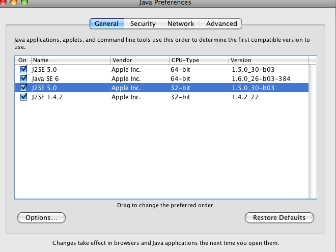

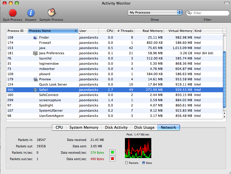

Then, identify if the browser is running in 32-bit or 64-bit. You can do that using "Activity Monitor.app". The row will show your browser name, and the column labeled "Kind" will show 64 bit or not.
Finally, use Java Preferences to rearrange the order of Java versions so 1.5 64-bit is above 1.6 64-bit. Or disable 1.6 64-bit and 1.4 32-bit.

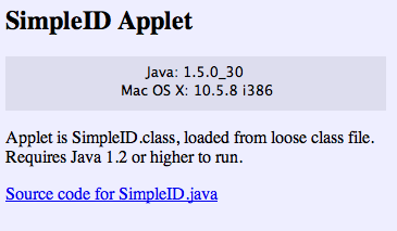

I uploaded a simple Java applet that identifies the Java version and OS version currently in use. It's compiled for Java 1.2 or later, so it should work on any Java version that was ever released on any Mac OS X version.
I may not leave it up there for long, so try it while you can.

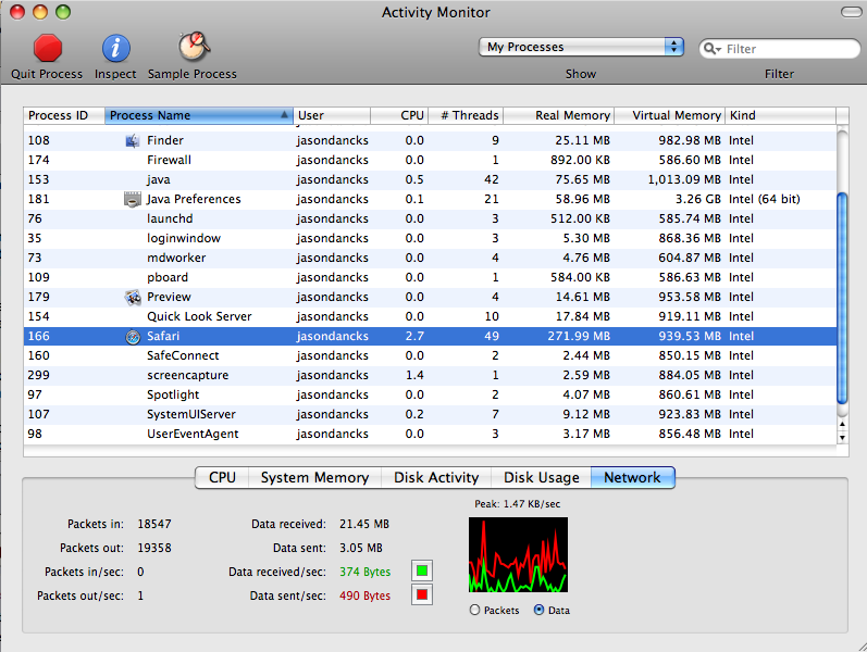

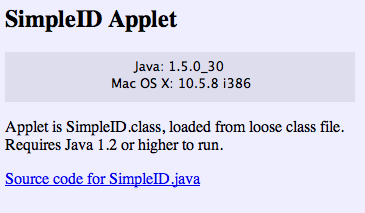

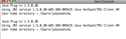

Im using safari
and:
so I'm guessing from what I see there its 32 bit, since only java preferences is listed as 64 bit and in parenthesis.

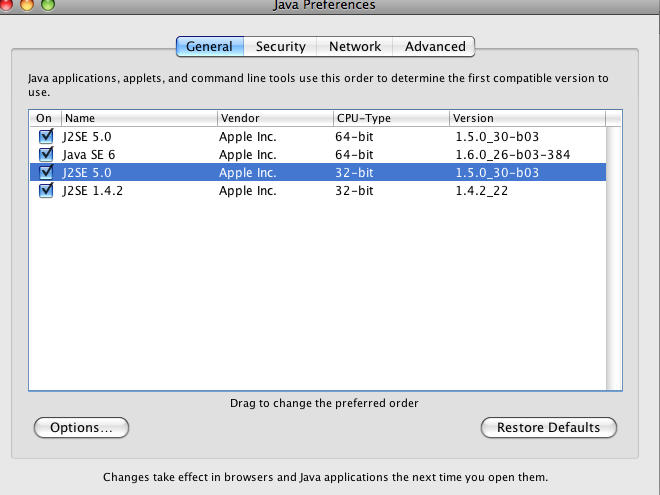

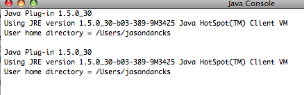

and:
So I think thats what you wanted me to do but its still giving me the same result.

hey it worked. Thanks RDO!
well, it worked on the iMac 10.6, not my macbook 10.5
I don't know what else could be the problem then...
You followed chown33's advice on the 10.5 pc too, right?
You might try clearing the cache and then reloading the applet...
I did everything he told me to do. I'm starting school in less than a week I'll ask some of the smart people hanging around there what I'm doing wrong. I'm sure they'll have a good laugh at my expense first but its all worth it. I'll look around and try different stuff when I finally have it figured out I'll post the solution
I put the image on my desktop on the 10.5 and it worked like a charm. The dumbass award goes to yours truly.
I'm just curious why that would matter. Would it only be because that's where I saved the java code?
lol. it happens sometimes...
yes, wherever the compiled applet is located; getCodeBase() -
Gets the base URL. This is the URL of the directory which contains this applet.
