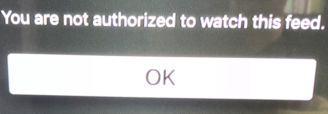

Last year I bought an Apple TV 4. It worked great for MLB.TV.
I live in Thailand.
This year I get an error message that says "you are not authorized to watch this feed".
I called MLB.TV and they had the audacity to tell me that their content on Apple TV "isn't supported in Thailand". Funny since it always was before.

What region is your ATV set to? I had the exact same issue as you and went into the settings and changed my region back to the US and it works perfectly.

By the way, did you get this same error message:

Update: I want to thank you. I set it back to USA as a region and logged back into the USA app store and all of a sudden it worked! It didn't work before.
