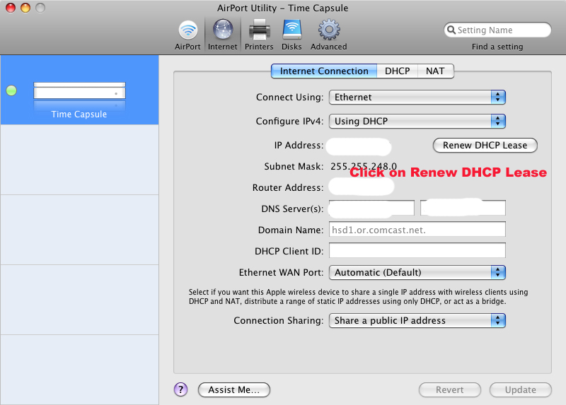

Use your airport utility to look at the router and make sure the DHCP is correctly done. It could be the Air needs to have the DHCP license renewed because the IP address assigned to it is being used by a different computer.
Open your Airport Utility.
Select the Airport.
Select the Internet Icon.
Make sure the airport has an IP address and domain name servers.
Click on Renew DHCP License.

Yeah both are currently enabled, what it says below my status is "Airport has a self-assigned IP address and may not be able to connect to the Internet."
