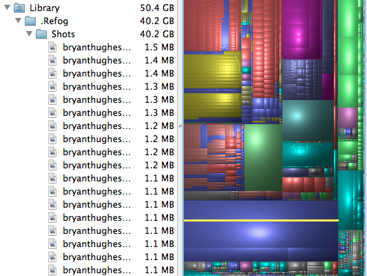

So I've spent a good amount of time browsing forums and troubleshooting every possibility. I installed Refog, a keylogger, over 2 years ago and instantly deleted it. Turns out I never uninstalled it, thus it has been taking 1mb screenshots every 5 minutes for a very very long time. It's accumulated upwards of 120GB of jpgs.
Now, I've used Disk Inventory X to see where these are hidden, in the library folder called .refog. Problem is that after unhiding the library folder, there is no .refog folder. I've also used the Disk X application to "Show in finder" the folder, and it just takes me up to the library folder. I've /.refog via the finder go to page. Tried directly deleting from Disk X.

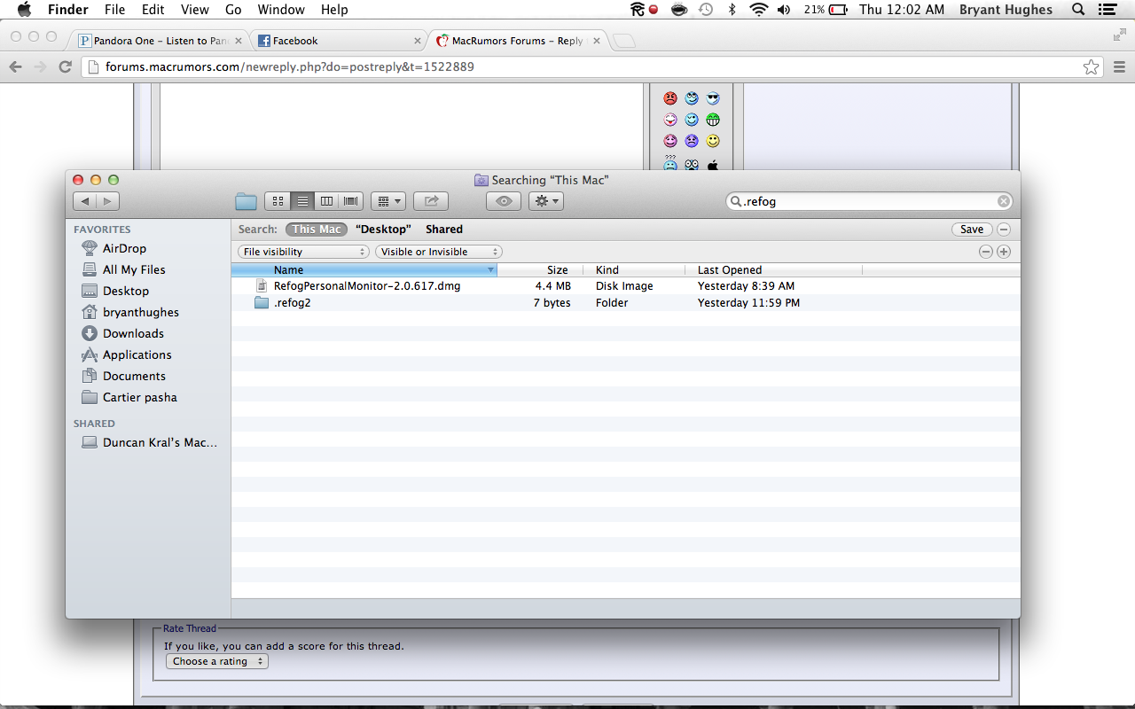

Then what are your exact search criteria?
Can you make a screenshot and attach it to your next post?
This is what I'm working with.

When doing it, it pulls up a .refog2, but the standard .refog is mia still.

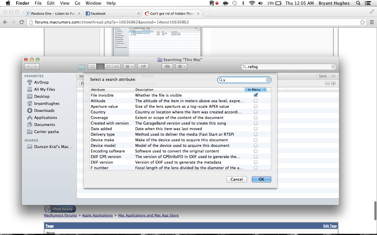

As I am not in front of your computer, I would just like to check what settings you chose. Nothing more.
Also add the "System Files" criterion to see, if it shows up and limit the search to the Library folder via going to that folder and pressing CMD+F.

Yeah, going to the library didn't affect it, still just pulling up the .refog2

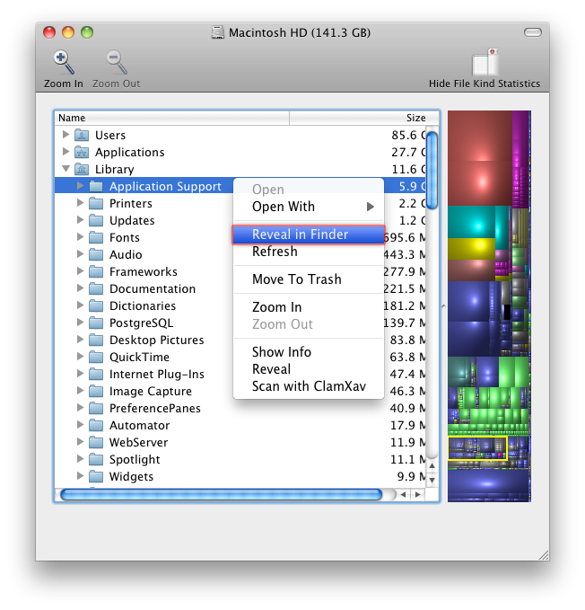

What happens if you right click on the folder in Disk Inventory X and select "Reveal in Finder" and then go up one folder via CMD+ArrowUp?
Nope, just brings me to the library folder, with no .refog folder. It's seriously frustrating haha. I might just have to take my computer into apple to have them take a look at this.
