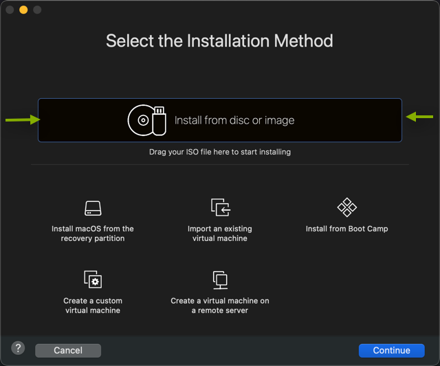

To create this VM In VMFUsion, you just install the VM from an ISO image you download by dropping it into VMFusion's "New" setup. The VM Image needs to be able to interact with the host OS. Current Macs don't have CDs or DVD drives as far as I know (mine doesn't).

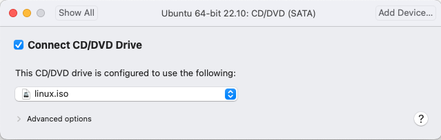

I also have no cd-rom. It's not a real cd-rom I'm talking about. I went to the VMware settings of the Virtual Machine. I had a CD/DVD device there (you can add it if you don't see it). Then, in the properties of that device, I selected the "linux.ios"

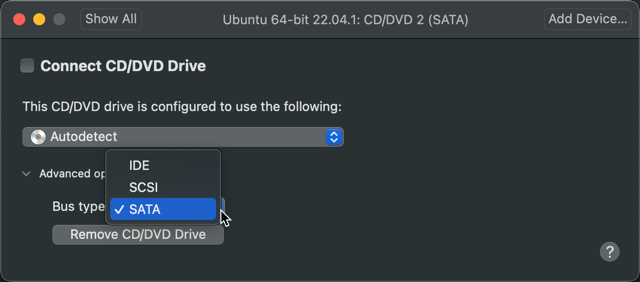

Could you post a screenshot showing what you did? Here's what my CD properties looks like (no linux.ios):
That linux.iso was a file on my desktop copied out of the Application's bundle. In that dropdown just select "choose a disk or disk image..." and navigate to where you have that iso.
