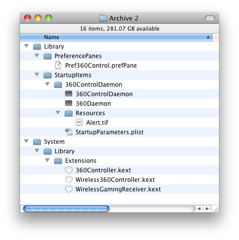

I know I need to uninstall tattie, but after trying to reach the creator with no success, there has to be some sort of buried file that I cannot find to remove. To me, it looks like I removed everything, but it's obviously not the case. Edwin, do you know the name of every file that tattie downloads on computers and their locations? This would greatly help our cause. Thanks in advance.
I broke open the installer for the 360 drivers and the following files appear to be everything that gets installed. Don't know if this will solve your problem but I hope it helps.
The "Library" & "System" folders in the image above are the ones on the root level of your hard drive usually called "Macintosh HD".
Edwin
Thanks. Erased them all and still does not work. Bummer.
Yeah the 360 Pad support appears to be a bit of a dark art right now. If you do find a solution please let us know, in the meantime I can tell you we are looking at what we can do to improve the 360 pad support or at least work out what is going wring with the drivers. If myself or anyone at Feral finds out anything more about what other files might be altered I will make sure this thread is updated.
