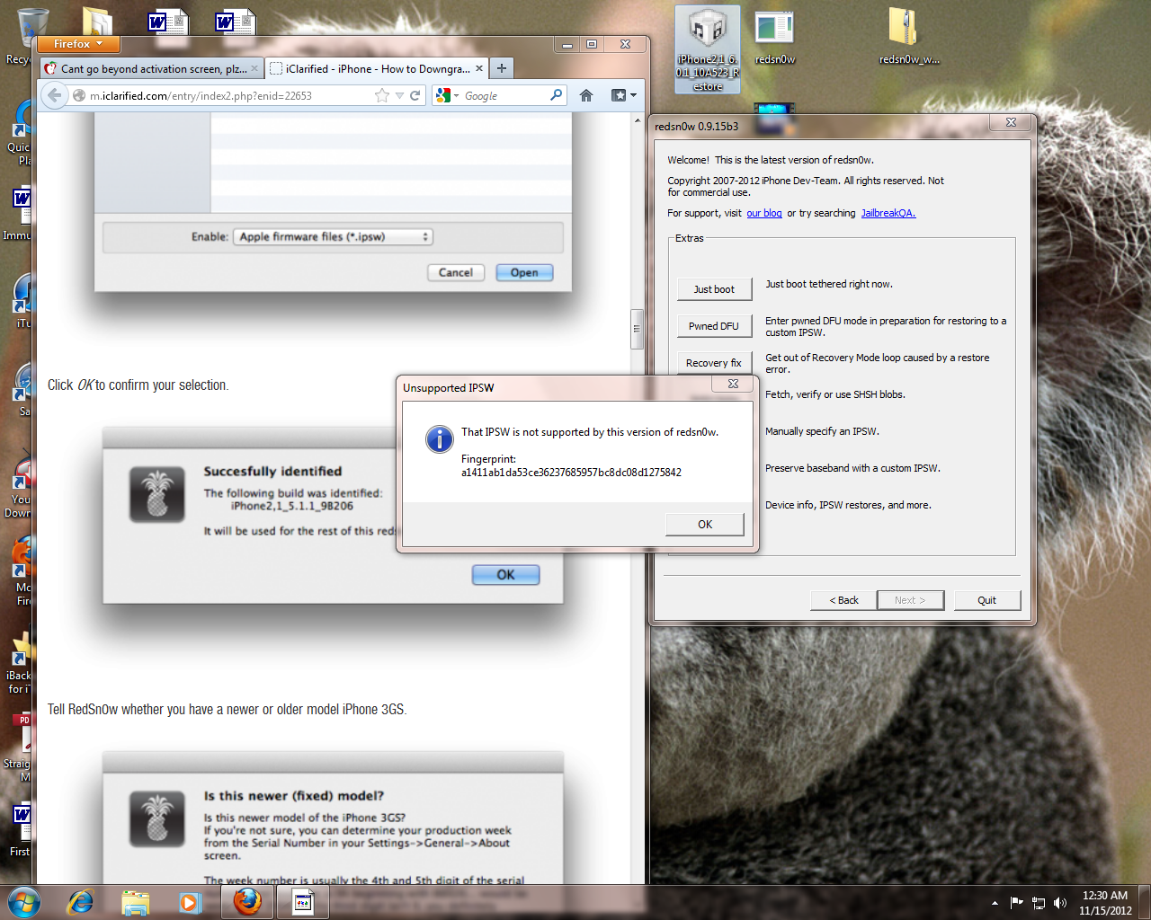

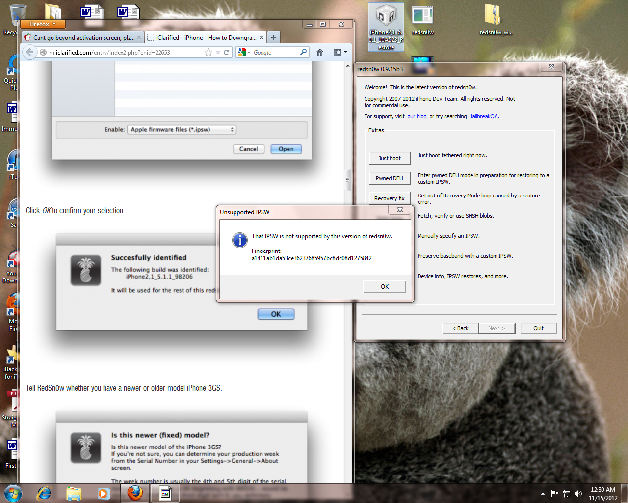

i just tried what you told me to do. I downloaded 3gs 6.01 firmware as I am thinking when i restored just now so I shud be using that right?
and see the pic I attached, it says redsnow is does not support this😕😕
Just select/point it to the 6.0 firmware.
It will recognize it and go on with the rest of the steps.
Not sure about that issue.
Seems like redsnow is crashing on your computer or something.
Try doing it on another computer.

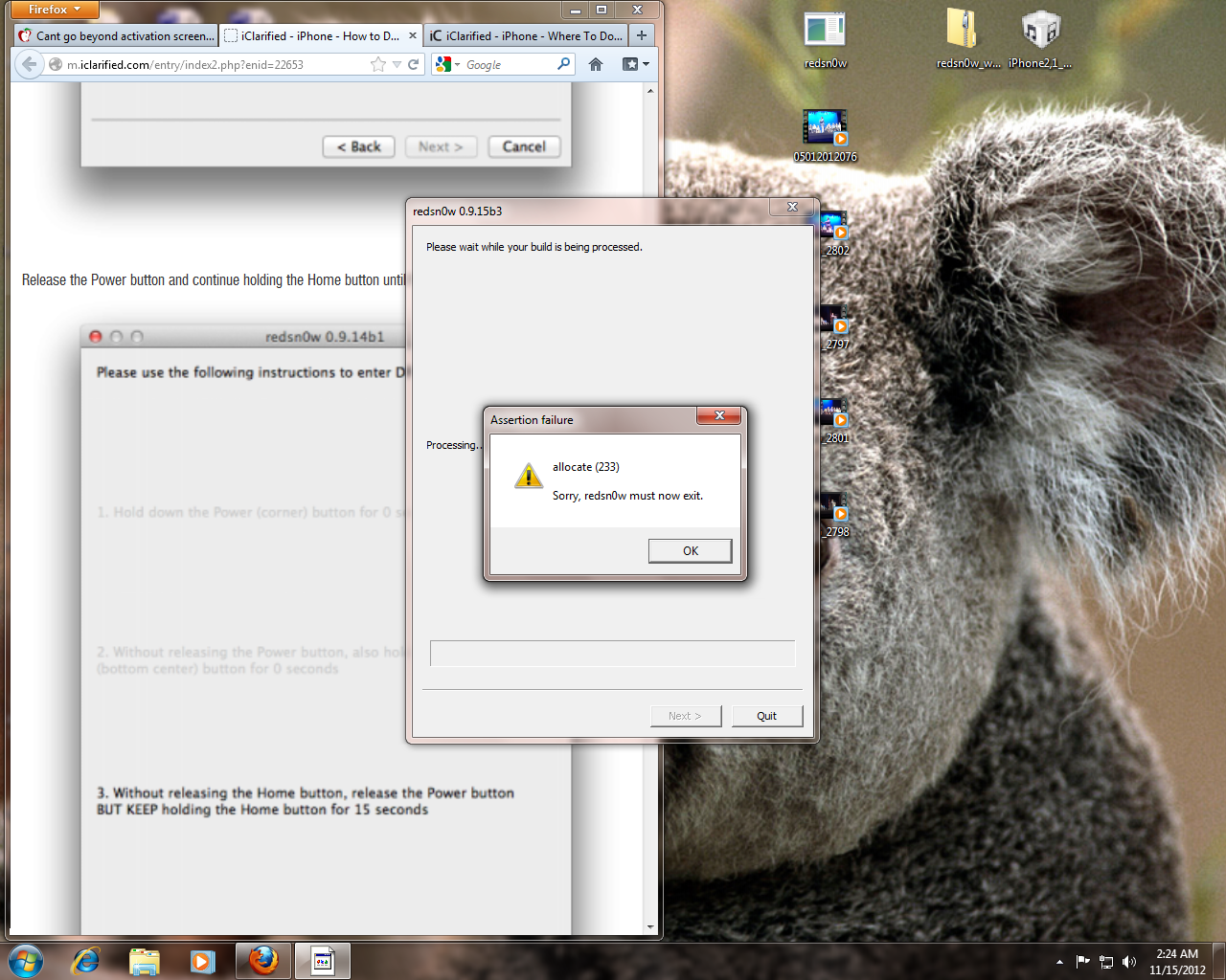

i figured what the problem was, I was clicking on "instal ipad bb" and instal "cydia" at the same time. I read your screenshot and this time only clicked "instal ipad bb". This worked but now I am getting a screen saying " this device connected does not support unthetered options" and than it doesnt go anywhere from there so I just quit the installation.
