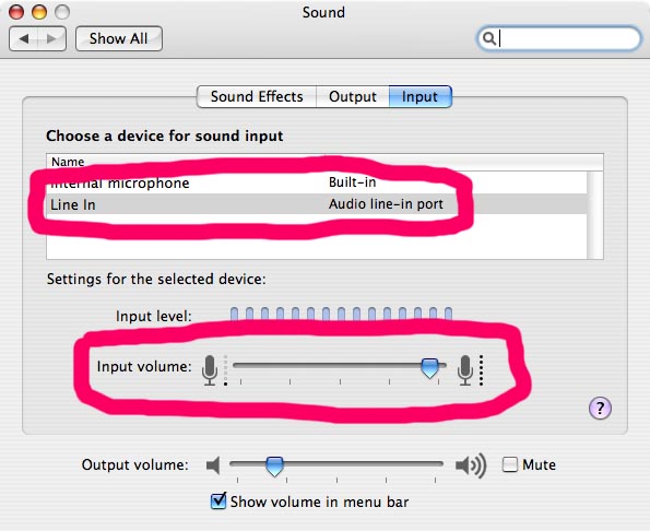

Picked this up from the Apple Store in London a few day ago and I've been having some trouble getting my electric guitar to work with my mbp. When I plug everything up and try and play it records through the mic on the mbp and not through the pickups. In system pref>sound>input I have line out selected along with the volume all they way to the write. What am I missing here?

You've selected Line Out for the input?
Do you mean Line In?
Or is it Built-in audio selected.
Also is the monitoring turned on?

There is no need to use an amplifier, you can plug your guitar straight in - just make sure that you have selected line in (both in garageband and on 'sound' in system preferences).
This is what I use and it works for me.
Sounds like you're doing pretty much the same.

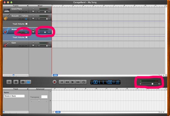

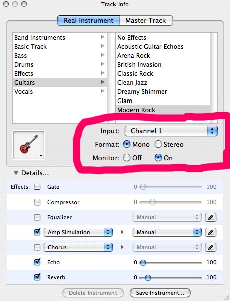

I circled the key points that can make it so that no sound comes out, so look into those options.

If you are using an interface the key to getting sound through Garageband with a guitar is to tell GB to listen with the internal card not the interface. It is unlike amp software and I have no idea why GB wants it this way but it will not work selecting the interface as the input. I have several versions of amp software. All of those need to be set up with the interface as the input. Most do not have an option to select separate input and output devices so everything comes and goes through the interface. Yet GB only picks up the guitar signal if you tell it to look for the internal system source instead of the interface. You do have the option of selecting something else as the output, either the interface or the computer headphone jack.

step 1 under preferences/audio make sure system input is selected
now make a new basic track
here is the important step under track info, turn monitor 'on'
YOU ARE DONE AND YOUR WELCOME
