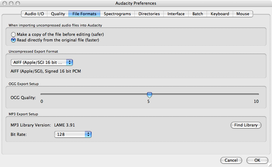

Audicity definitely exports to AIFF, and they normally import into iTunes fine... Does your Audicity Preferences window look like this?
As there are 3 types of AIFF and 5 of WAV, some of the types of WAV wouldn't play on a PC so maybe some types of AIFF don't play on a Mac... Make sure the top one is selected.

Sixteen Bit PCM!
The key in the above screenshot is the setting "16 Bit PCM".

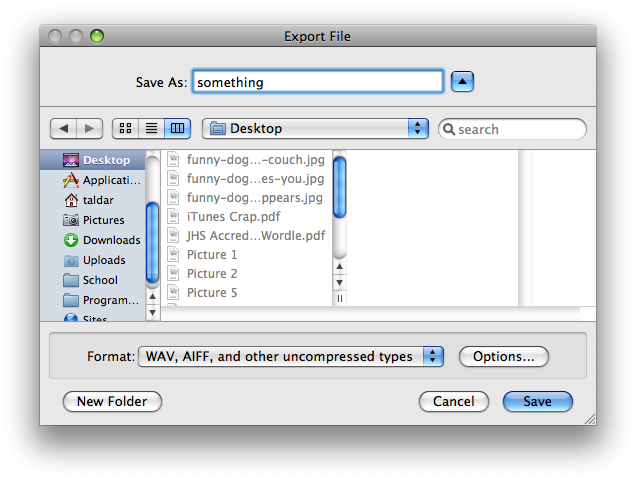

When Exporting as AIFF, click options…

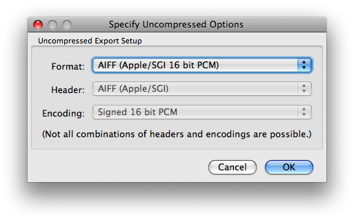

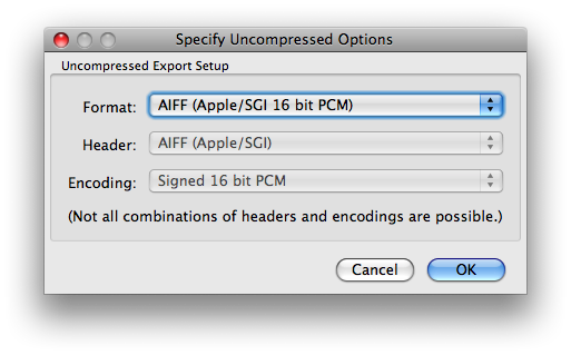

…Then set the Format to AIFF (Apple/SGI 16 bit PCM)

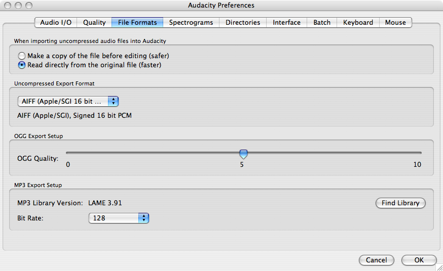

I was having the same problems, and this minor change fixed it.
Hope it works for you.
