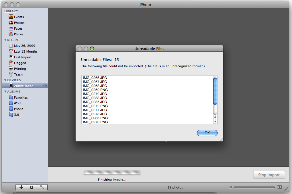

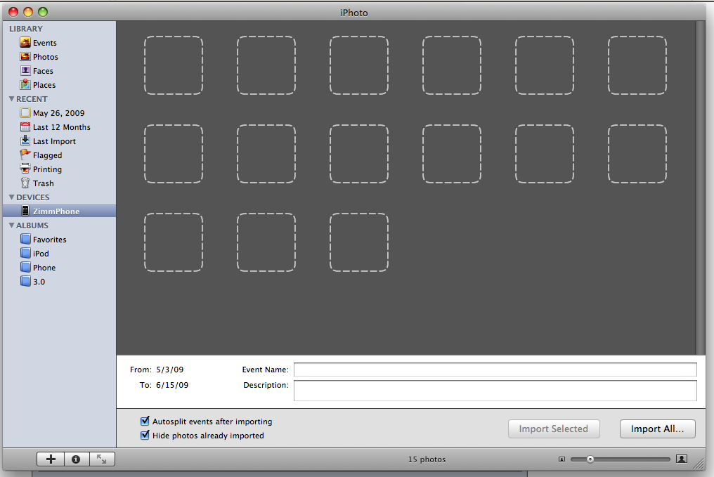

Now they show up just fine on my phone, but when I open iPhoto this is what I get. Then when I try to import the second picture is what I get.

Try importing them perhaps using the 'Image Capture' application. I usually get my iPhone photos using that. This just started happening with 3.0?
hmmm. Well first I tried importing through photo capture, it showed it working but no files went into either the photos folder or a folder I set up therein afterwards. Then I deleted all my photos on my phone, they still showed up on both iPhoto and image capture, I tried to import, no luck. I took a picture but it only recognized the photos that I deleted, trryed to import once again no luck =/. I restarted my phone aand then it only recognized the one photo i took. And I used image capture to import. I'm not going to be using iPhoto anymore, thanks for the help! =]
