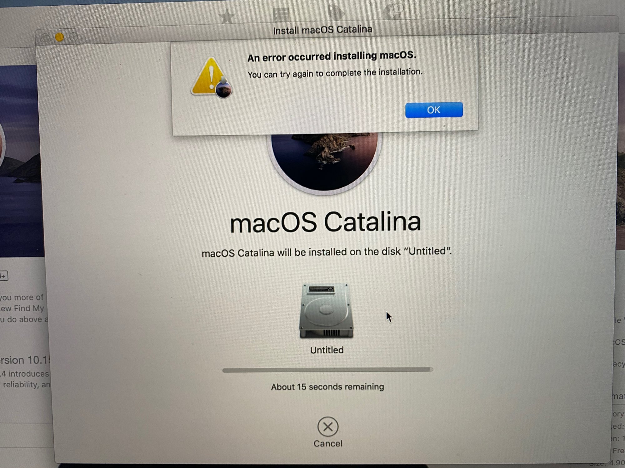

I only ever get the same message, that an error occurred and I can try again
I can get to the utilities menu using the method you mention and I’ve also tried to install that way using the “install latest Mac OS” option
At the end of that process I get the same error message
An error occurred installing macOS
You can try again to complete the installation

Hmmm. I just tried again (internet recovery - erase disk - install MAc OS) and the exact same error. One thing I’ve noted though is that it says installing Mac Catalina Beta (19B77a). I wonder if that is why it’s failing. I’ve turned off beta but it still says that when trying to install

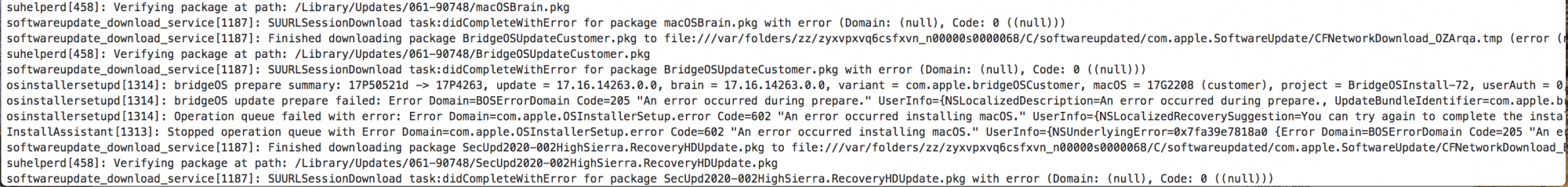

Try opening the installer again on High Sierra, then press COMMAND and L at the same time. It should tell you what error is happening when the error message pops up, let us know what the last line of error is.
Ok, went through the whole process again. Same error
last few lines of log are
Apr 2 14:44:34 Alistairs-MacBook-Pro osinstallersetupd[1314]: bridgeOS update prepare complete
Apr 2 14:44:34 Alistairs-MacBook-Pro osinstallersetupd[1314]: bridgeOS update prepare failed: Error Domain=BOSErrorDomain Code=205 "An error occurred during prepare." UserInfo={NSLocalizedDescription=An error occurred during prepare., UpdateBundleIdentifier=com.apple.bridgeOSCustomer, NSUnderlyingError=0x7fdf48362c60 {Error Domain=BridgeOSSoftwareUpdateError Code=19 "MSU - 1041 (failed to perform limited firmware update);MSU - 30 (Query for AP nonce failed);" UserInfo={SystemPartitionSize=1979666432, MSUErrorCode=1041, MSUErrorDescription=failed to perform limited firmware update, NSLocalizedDescription=MSU - 1041 (failed to perform limited firmware update);MSU - 30 (Query for AP nonce failed);}}}
Apr 2 14:44:34 Alistairs-MacBook-Pro osinstallersetupd[1314]: Operation queue failed with error: Error Domain=com.apple.OSInstallerSetup.error Code=602 "An error occurred installing macOS." UserInfo={NSLocalizedRecoverySuggestion=You can try again to complete the installation., NSLocalizedDescription=An error occurred installing macOS., NSUnderlyingError=0x7fdf4ddf47f0 {Error Domain=BOSErrorDomain Code=205 "An error occurred during prepare." UserInfo={NSLocalizedDescription=An error occurred during prepare., UpdateBundleIdentifier=com.apple.bridgeOSCustomer, NSUnderlyingError=0x7fdf48362c60 {Error Domain=BridgeOSSoftwareUpdateError Code=19 "MSU - 1041 (failed to perform limited firmware update);MSU - 30 (Query for AP nonce failed);" UserInfo={SystemPartitionSize=1979666432, MSUErrorCode=1041, MSUErrorDescription=failed to perform limited firmware update, NSLocalizedDescription=MSU - 1041 (failed to perform limited firmware update);MSU - 30 (Query for AP nonce failed);}}}}}
Apr 2 14:44:34 Alistairs-MacBook-Pro InstallAssistant[1313]: Stopped operation queue with Error Domain=com.apple.OSInstallerSetup.error Code=602 "An error occurred installing macOS." UserInfo={NSUnderlyingError=0x7fa39e7818a0 {Error Domain=BOSErrorDomain Code=205 "An error occurred during prepare." UserInfo={NSUnderlyingError=0x7fa39e7ea3b0 {Error Domain=BridgeOSSoftwareUpdateError Code=19 "MSU - 1041 (failed to perform limited firmware update);MSU - 30 (Query for AP nonce failed);" UserInfo={SystemPartitionSize=1979666432, MSUErrorCode=1041, MSUErrorDescription=failed to perform limited firmware update, NSLocalizedDescription=MSU - 1041 (failed to perform limited firmware update);MSU - 30 (Query for AP nonce failed);}}, NSLocalizedDescription=An error occurred during prepare., UpdateBundleIdentifier=com.apple.bridgeOSCustomer}}, NSLocalizedRecoverySuggestion=You can try again to complete the installation., NSLocalizedDescription=An error occurred installing macOS.}
I saved the entire log and you can see it here

Looks like the Catalina installer is choking while you are booted to High Sierra.
Use the Catalina installer app to make a bootable installer on an external drive, then boot to that Catalina installer.
That should eliminate any effect that the High Sierra system has on the Catalina install.

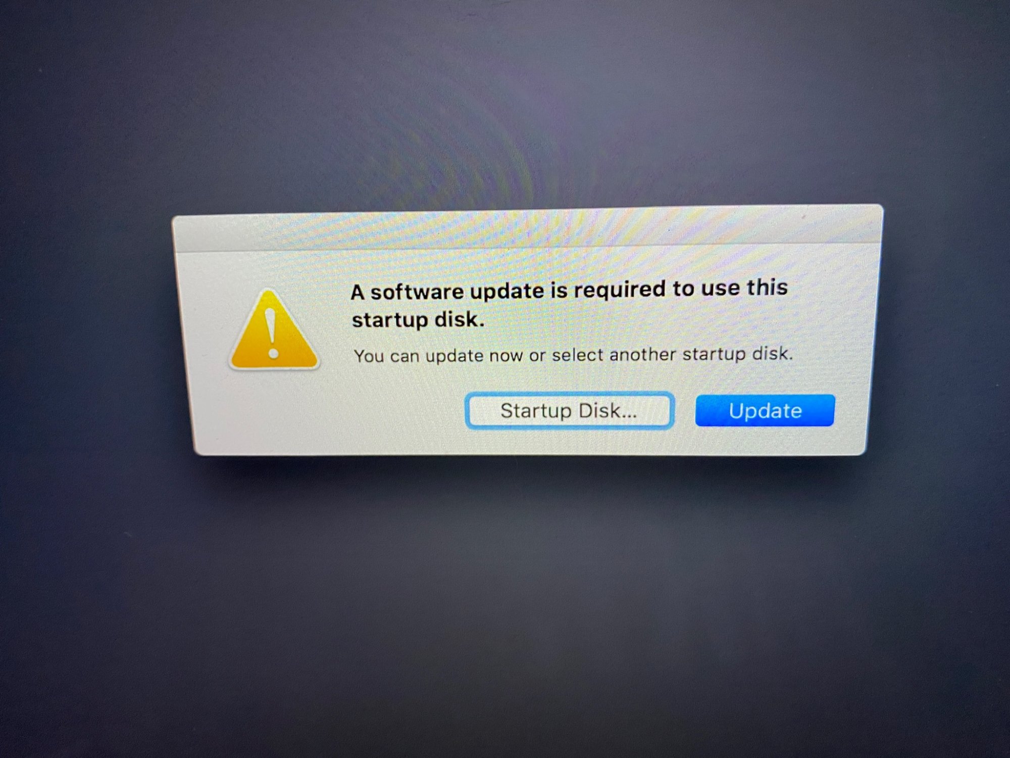

Followed your instructions and first I got this

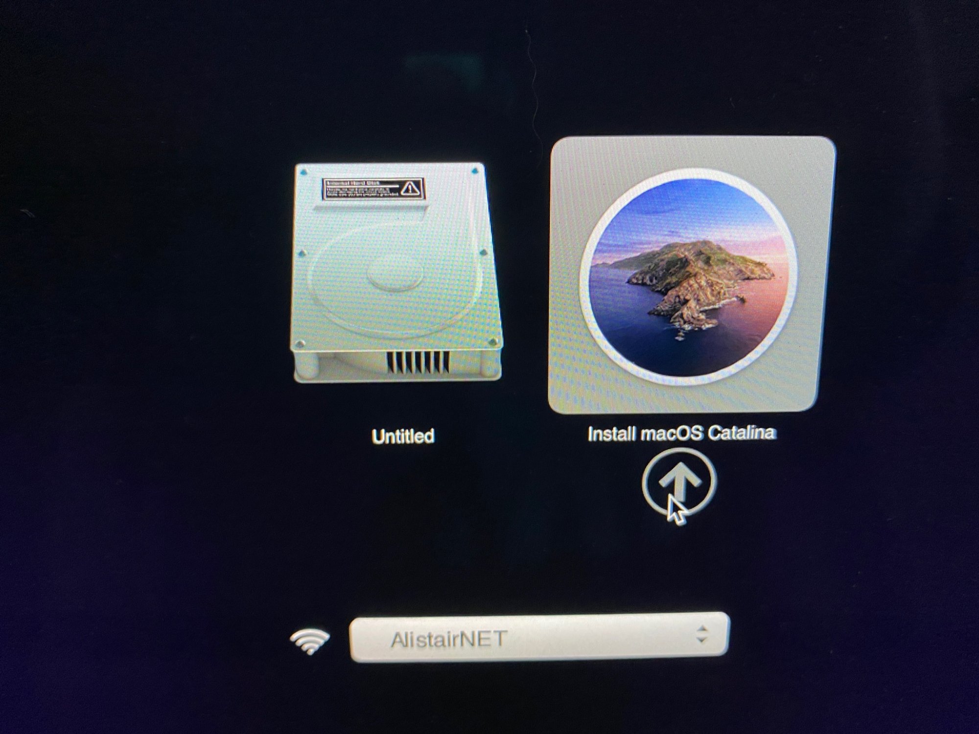

So I selected my Catalina start up disk (the usb drive) and then I get this

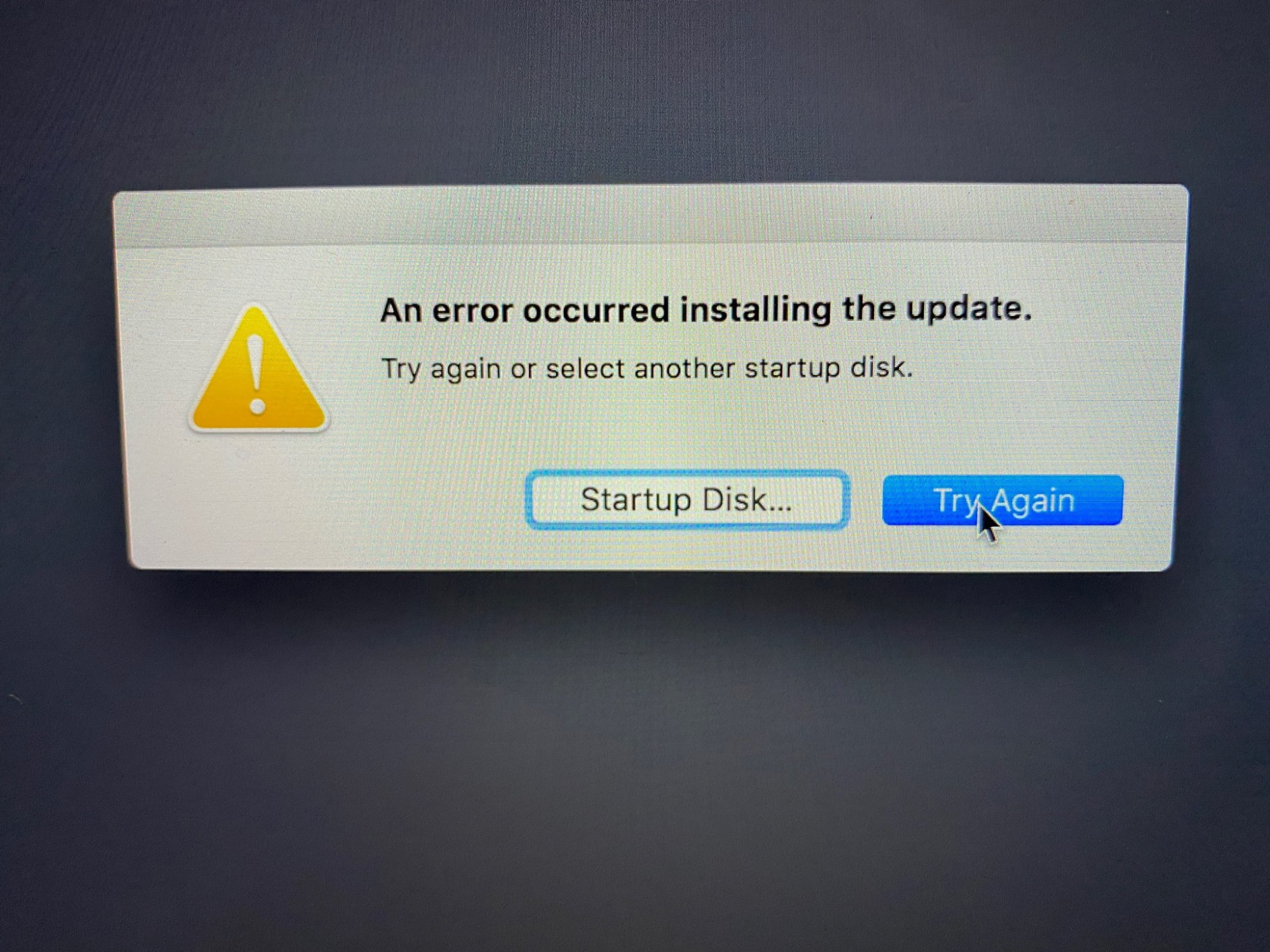

So I select update and the get this
And I’m back to square one

1. Install/Upgrade to macOS Mojave first. Mojave bought in a lot of firmware updates and presently the error from the installation log indicates a firmware error. Upgrading to Mojave first will resolve.

High Sierra and Mojave's security updates both install the same firmware updates that the 10.15.4 installer would. I suspect, based on your log files, that installing the 2020-002 security update will also fail, but if not, then Catalina would probably install fine after installing that security update.
