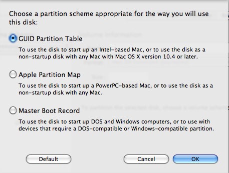

Another question- when the drive itself in question is selected in Disk Utility (not the individual partition), what does it show at the bottom of the screen where it lists "Partition Map Scheme:"?
For a G5 (or any other PPC based Mac for that matter) it should read APM (for Apple Partition Map) in order to be a bootable disk. If the disk was originally a PC formatted disk (as virtually all new blank disks are) before partitioning, it will probably read MBR (for Master Boot Record) if the "options" button at the bottom of the partition pane in Disk Utility was not changed.
If that is the case, then you have two alternatives that I can see:
• Although you don't want to, reformatting and repartitioning with the correct "APM" selection made in the partitioning options (example of choices in that box shown below)
• Google "installing osx on mbr partition" which will give you some hacks/workarounds mostly based on hackintosh projects where an MBR partitioned disk has to be used. I am not at all up to speed on that whole side of things so can only suggest that search.
Now on the chance that it does NOT read "MBR" then disregard all the above! 😉

I would add, that although the newest (2005) G5s can boot from GUID (intel) partition drives(but OSX installer won't let you install to it), I don't know if any PPC can boot from MBR. Does anyone know?

Thank you so much for your thorough answer. It indeed states that the previously Windows-formatted disk is MBR! Now I understand the problem and know how to go on with the installation. 😀
So tricky to have PC and Mac after all! 😉
