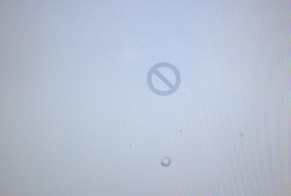

I have a little problem with my 2010 MacBook Pro 13". I was unable to start my Mac, when at the apple boot screen, after a little while, the apple changed to a prohibitory sign and the little circle kept spinning. Weirdly, I was still able to boot into my Bootcamp partition. I was unable to repair permissions or wipe the HD using my recovery partition, the disk utility always froze and showed different errors. So I was researching this problem and some people with similar problems said it was a faulty HD in their case. So I purchased a new HD and put it in my Mac, connected a bootable Mac OS X Mavericks installer USB to my Mac, chose it as the startup device, and then the same problem, the apple changes to a prohibitory sign. Hmm..., do you have any idea what to do?
Thanks
EDIT:
here's the pic of the prohibitory sign in case you don't know what I'm talking about 😉 :
attachment.php

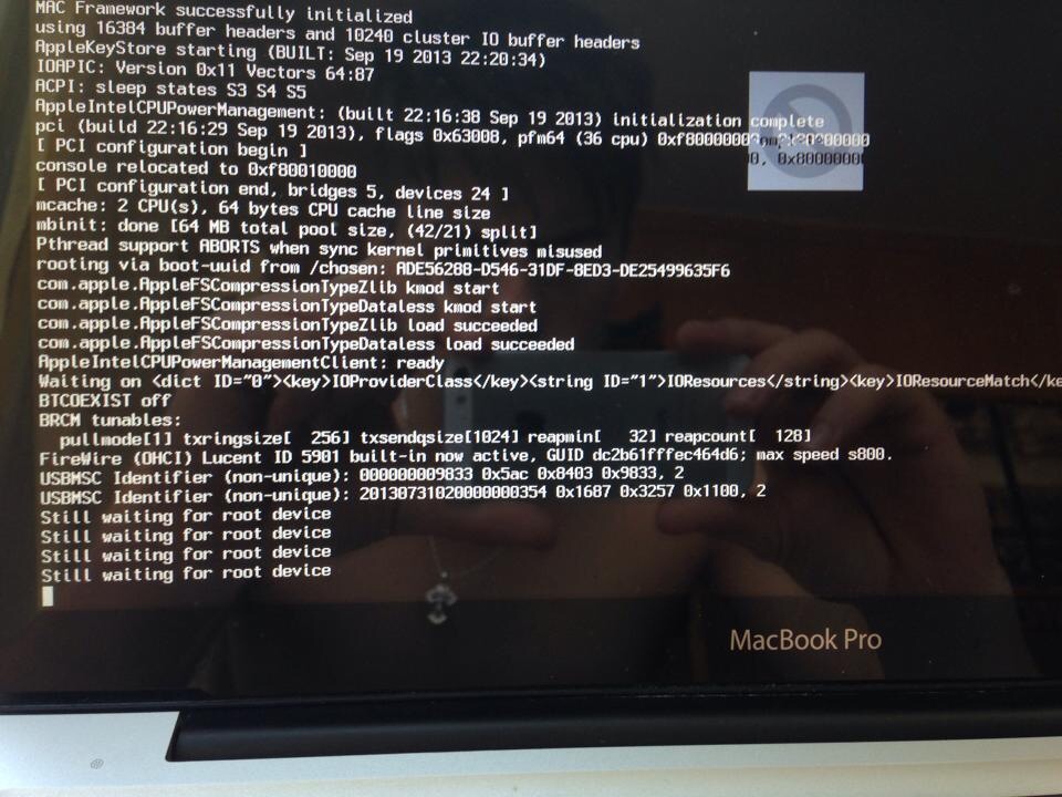

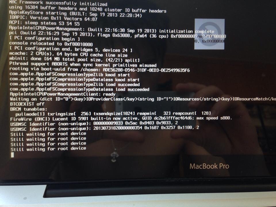

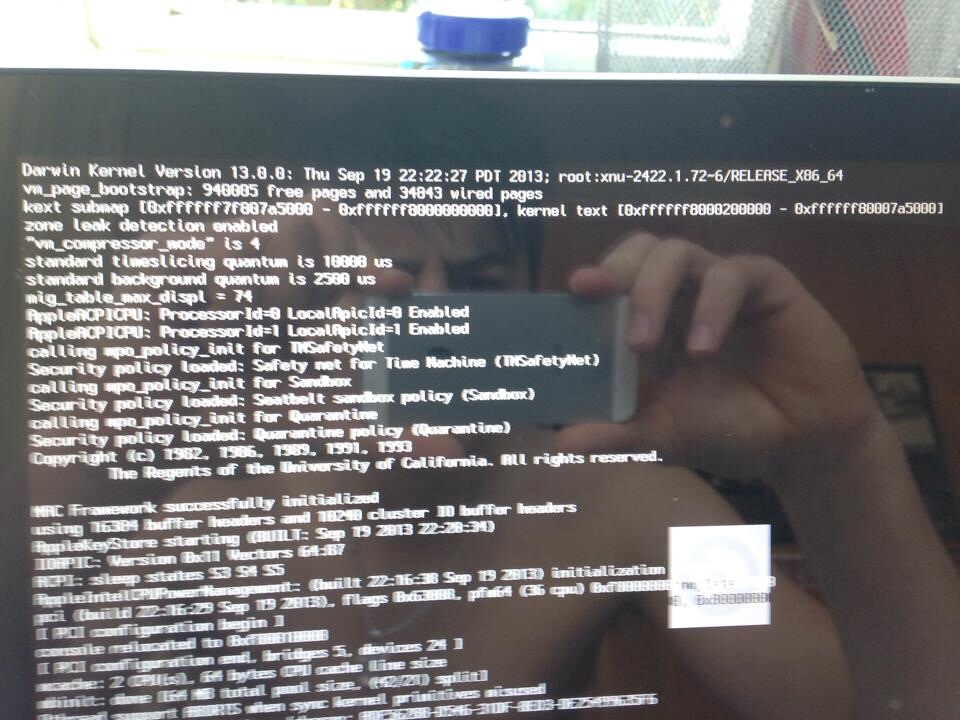

Reboot while holding Cmd-V to get more details, and take another picture when it freezes.

There's nothing obvious to me in the verbose log, but hopefully someone else will have some ideas.
Try disconnecting the internal HD and booting to the install USB.
If that doesn't work I'd try pulling/swapping RAM and trying again if you're up to it.
