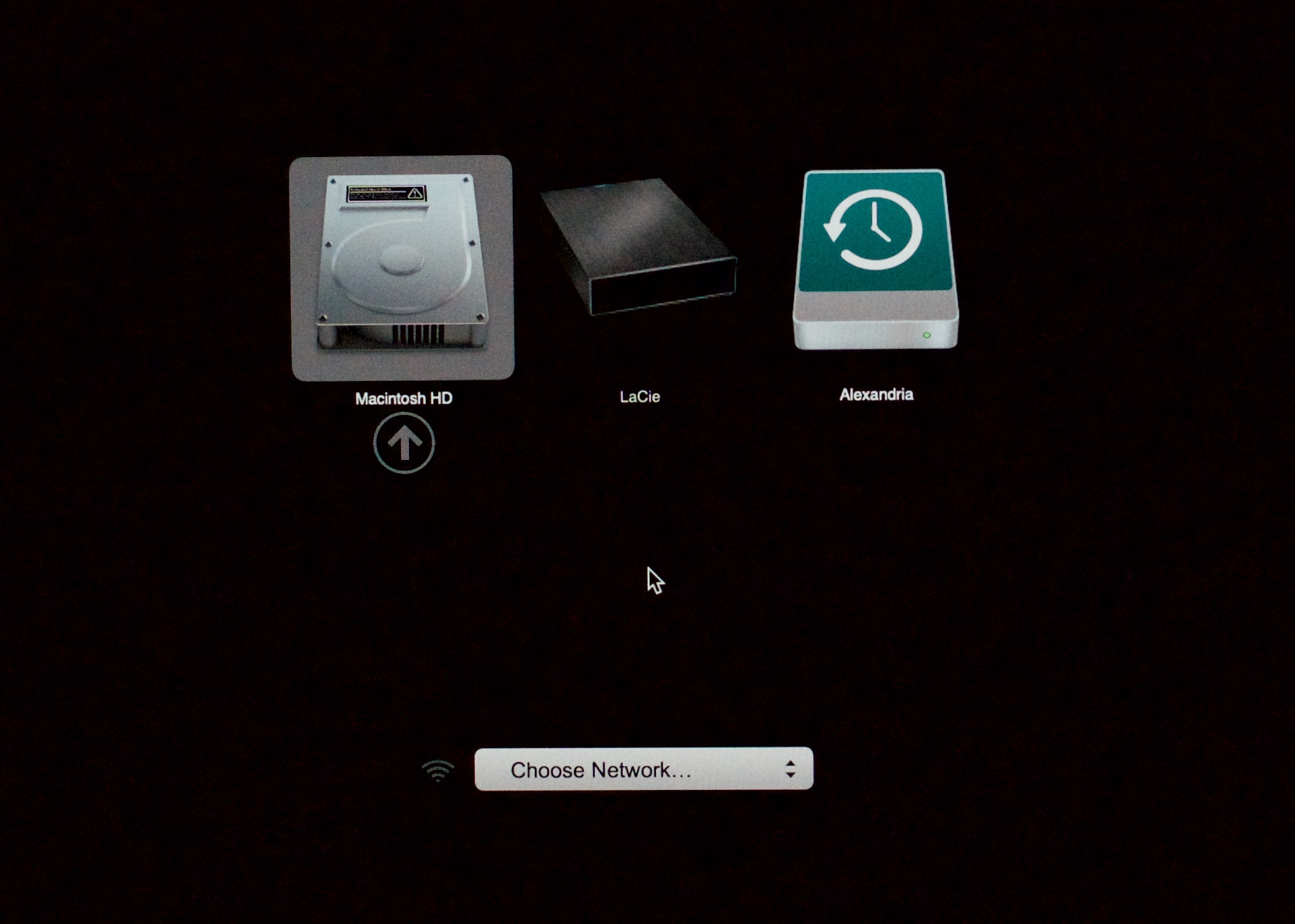

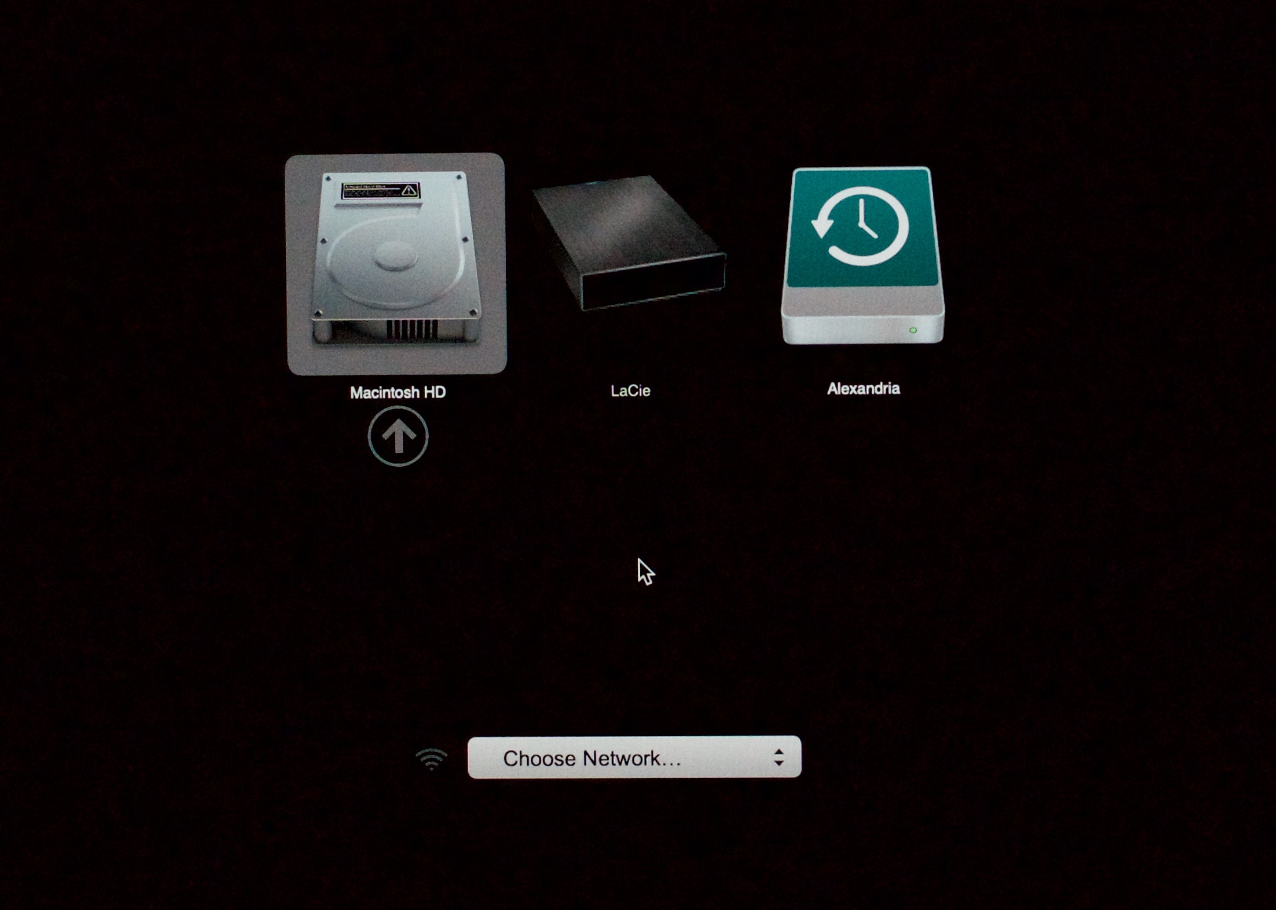

you don't get something like this at boot?
alexandria is my time machine drive.
however, if it's a network drive, you'll need to use the "Choose Network" menu

you don't get something like this at boot?View attachment 803132
The TM drive did not show up. Even when I chose my network the only option available was Macintosh Install or something to that effect. I had to hook up my external USB drive to boot the computer to erase the iMac drive
