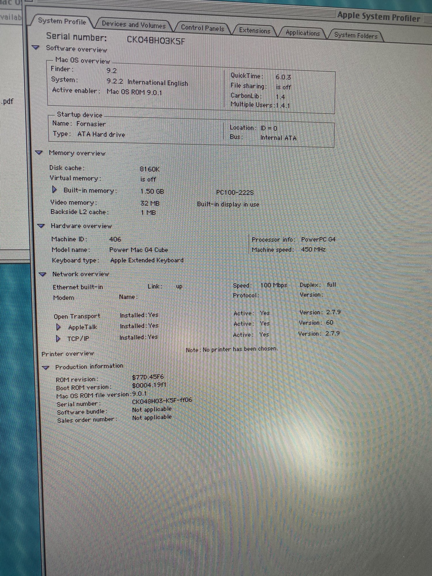

So i've opened it up now and I can't see anything that says the firmware but I attached an image to show you what I see. And yes it seems to read the cds fine when booted into OS 9, but the DVDs it can't always read, some read fine but others don't, but i'm guessing it is most likely because they are DVD-RW discs, which i'm guessing the cube can't read.

OK. This helps a little, though yes, this doesn’t indicate whether 4.1.9 was installed. But the serial would indicate your Cube was built at the end of 2000. The 4.1.9 updater was released early/mid 2001.
So… the first thing I would try to do is download the G4 Cube’s 4.1.9 firmware updater and follow the instructions on installing it. If it was previously updated by a previous owner, then the firmware updater should display confirmation of this and end the installation process before it would proceed. It would not need to be run a second time.
[UPDATE: Yes, your Cube is updated with 4.1.9f1, according to the last section]
