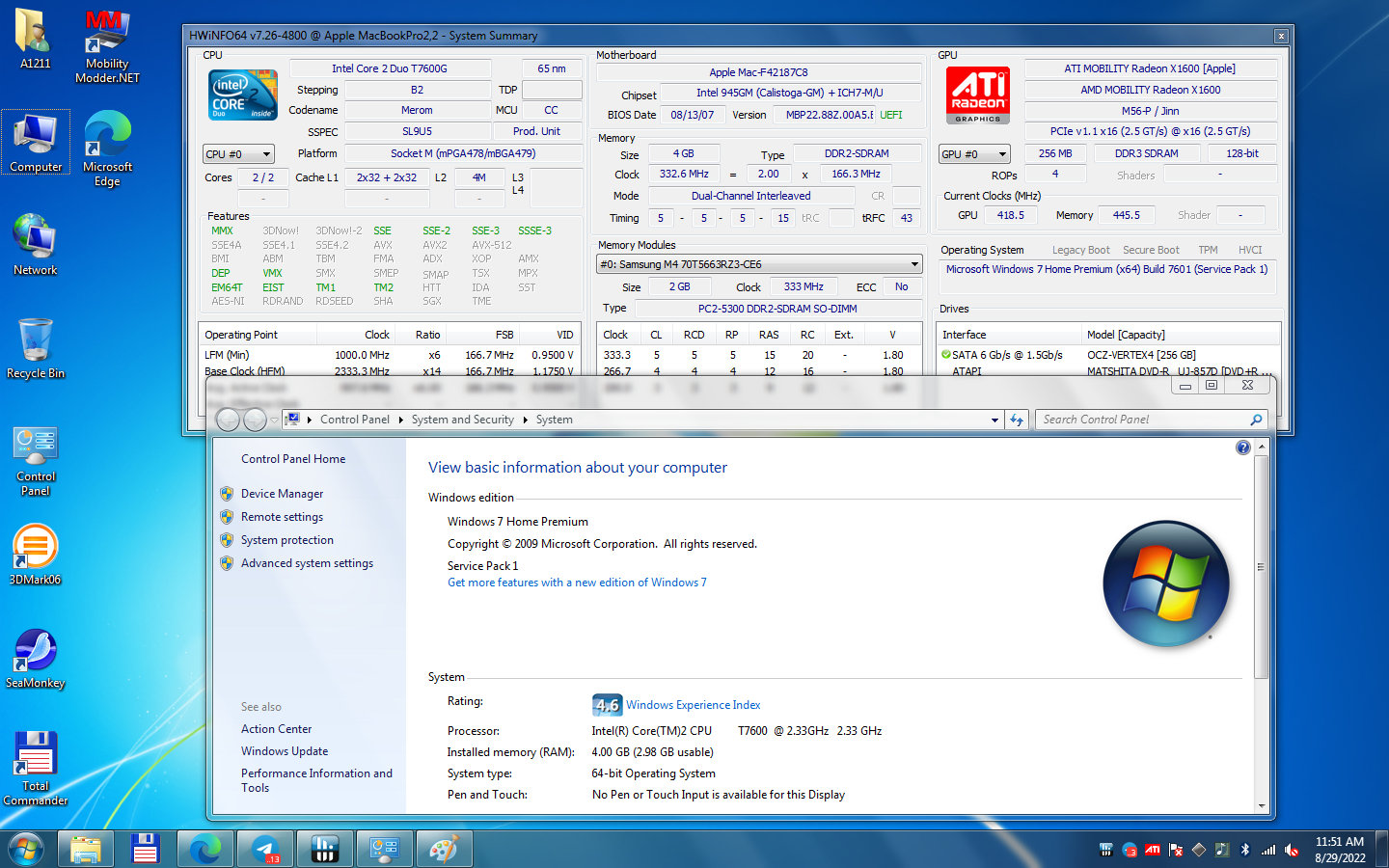

Guys, i'm terribly sorry. I was following guide without moving my brains. Instead of taking 32bit loader and injecting it into 64bit distro I dumped 64bit loader and injected it back 🙂
Now everything works! MacBook Pro Late 2006 running Windows 7 x64.
