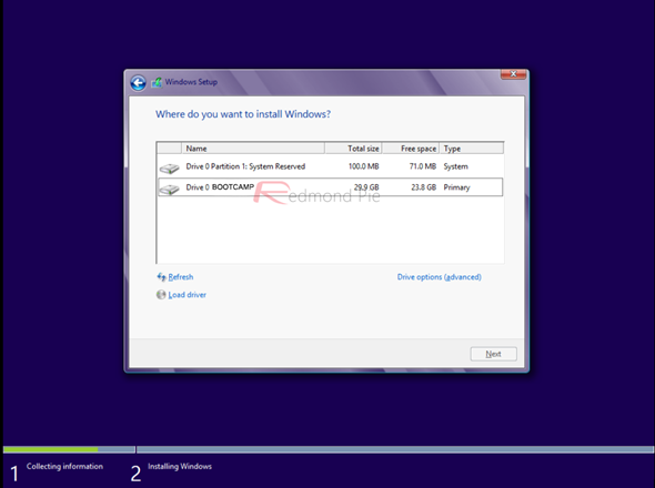

http://wiredwide.com/2013/06/30/how-to-install-windows-8-1-on-a-mac-using-boot-camp-5-drivers/
"Before the install process starts, Windows will prompt to select a hard drive to install the system. The right one is named “BOOTCAMP” in capital letters and has a dimension a little lower than the GB you gave it when partitioning the HD. Anyway, you can’t proceed since it is doesn’t have NTFS file system. Click the “Format” button and begin installing the software."
It's the option called "Drive Options (Advanced)

Yes it does. When you hit advanced you will be shown the options to format.
http://windows.microsoft.com/en-us/windows-8/clean-install
Look at steps 6 and 7.
"Follow the instructions on screen. When the installer asks you where to install Windows, select “Disk 0 Partition 3 BOOTCAMP” and then click Drive options (advanced). Choose Format from the options that appear to format the partition to NTFS, the file system Windows requires."
I did of course choose the BOOTCAMP partition. I didn't explicitly do this (drive options, choose NTFS). But I'm struggling to believe that the Windows installer might randomly decide not to use NTFS by default.
Windows installer will not format a partition for you automatically. Bootcamp Assistant created the partition for you, but its RAW. You need to specifically tell it to format NTFS. This is done to avoid destroying your data (if there was any). You may want to install to a different partition. Installer doesn't know that.
Since the partition Bootcamp Assistant created is RAW, Windows installer cannot install to it because it reads it as 0GB regardless of size. Go and format it like the Windows instructions I linked to say, and you will be able to install it.
Trust me, I've done this multiple times.
I just checked and there isn't a 'Drive options (advanced)' option at all. Looks like Microsoft have simplified the menu by having the 'advanced' options appear automatically. The format button doesn't give you a choice of file system. Again that's because Windows 8 only supports NTFS so there's no point in giving you a choice.
