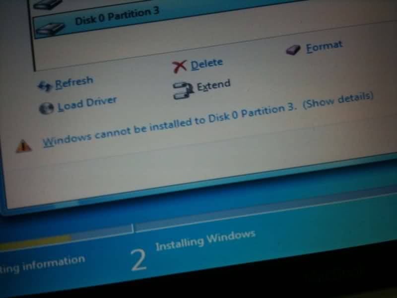

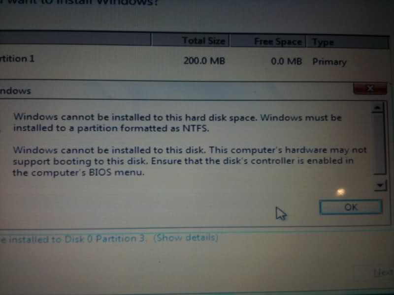

I figured the Windows partition corrupted itself after the power failure. I proceed to delete the windows partition via Boot Camp Assistant in OSX, divide the hard drive again, and go ahead with reinstalling Windows 7. But here's the problem I can't seem to figure out. When formatting the BOOTCAMP partition in the Windows Installer to NTFS, I run into this error:

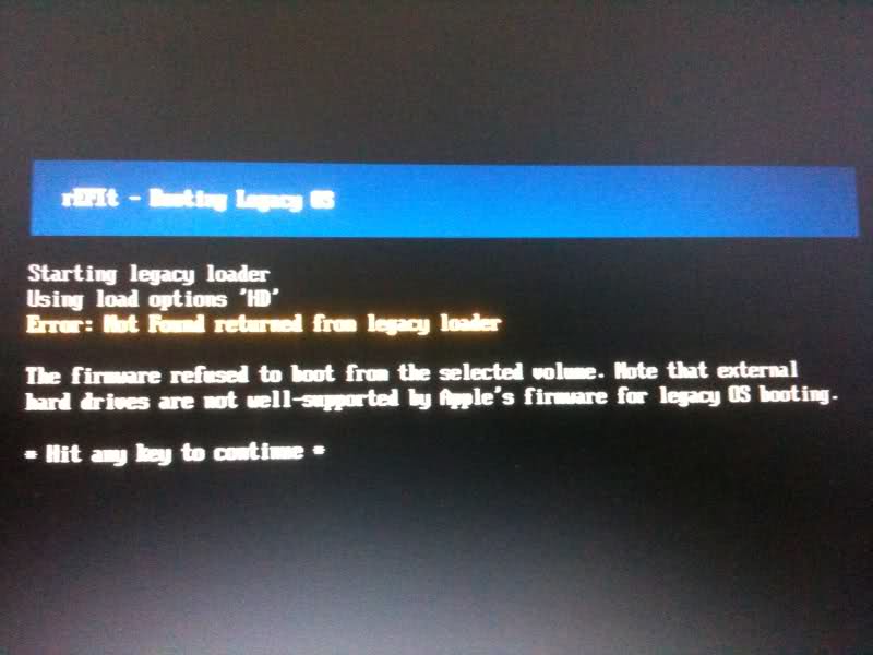

Did some research on google and decided to run rEFIT for its custom boot screen. For the heck of it, I decided to run the Windows Partition that was listed on boot screen. Here is where I run into this error:
It says: "The firmware refused to boot from the selected volume."
Could this be an EFI problem? Is something corrupted boot rom that is restricting me from booting into the windows partition? I already performed a reset for the NVRAM/PRAM and SMC.
Also tried to reflash the EFI again but OSX won't let me. It says: "This computer does not need this update"
Anybody have any suggestions? I'm way out of warranty and have no Apple Care. My macbook is painted so Apple Store help is out of the question.

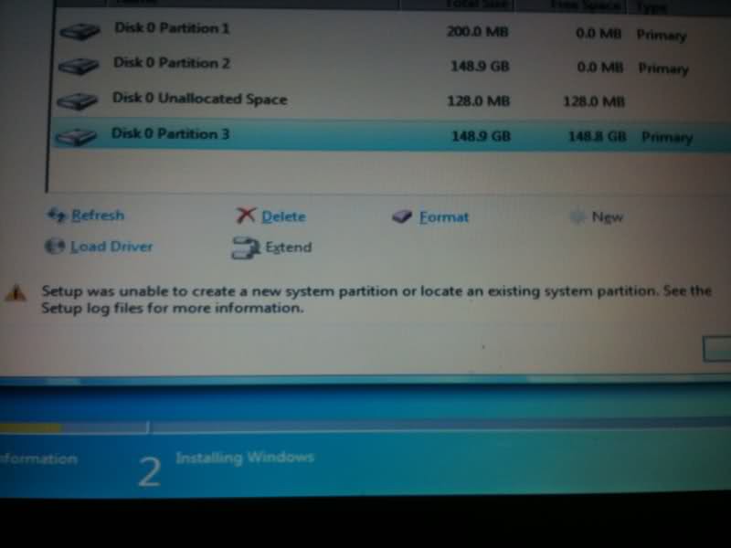

Personally, at your second screen shot I would usually use the "Delete" button to remove Disk(0)Partition(3) and create a new NTFS partition to install to there.
Also weird is that you have two ~150GB partitions on a 250 GB drive. This seems out of whack by the difference between GB and GiB.

You need to format the partition as ntfs, so click on the partition and click format. After that you wil be able to install windows.
Can't. An error appears (picture #2 above) when I press format on the target partition.
Why not remove every partition first, then just boot from the W7 install DVD and partition and format it during the install.
Tried this. I am still getting the same error.
