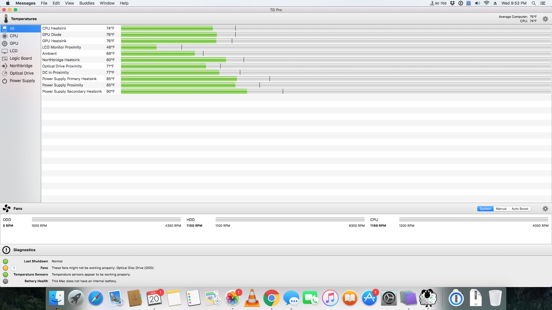

So I downloaded TG Pro and I've noticed that the program is not displaying my hard drive. My Macs Fan Control shows the SSD by model name and gives it a temperature value. The TG Pro has nothing. I opened up computer again and made sure the in line temperature sensor was seated properly and replaced the ODD fan with a used one. No change with the new fan. The screenshot of TG Pro is attached. Why is it not showing my hard drive if Macs Fan Control is showing it?

Well the early imacs had a fan issue as the hard drive being changed out caused fan weirdness. Dont worry about the sensor was my point because of that. Set one of the fan control programs to use another sensor close to control that fan. Again this is a known issue from way back. I didnt have 1 then to read the specifics, but a google may help that out. Any that I have fixed I just put in TG Pro set the screen temp as what drives the center fan and called it good.

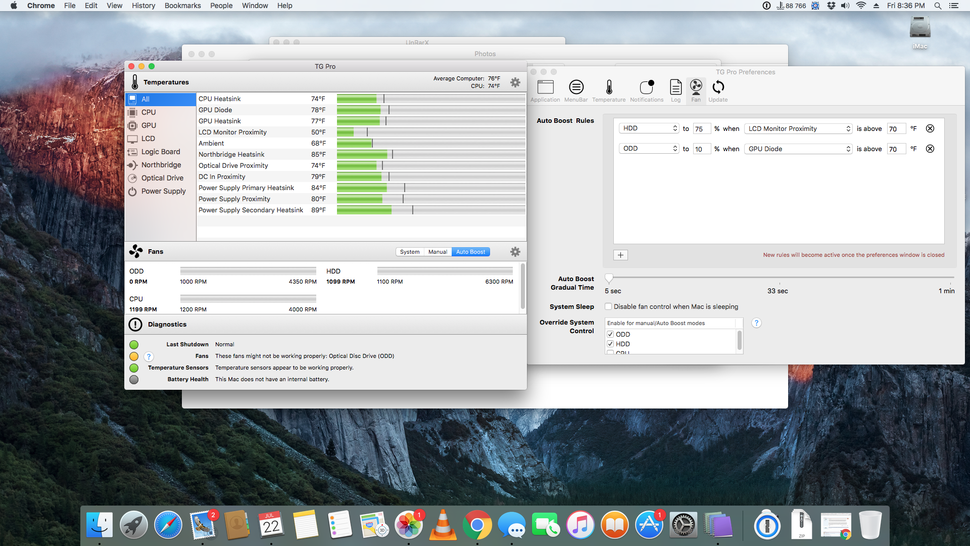

Okay, so I set up a rule that would have my HDD fan turn on to 100% when my GPU heatsink got above 70 degrees just to test. That seemed to work. The ODD fan just keeps on blowing though. I tried to link the ODD fan speed to the GPU heatsink temperature and set the fan to blow at 10% and there is no change to the sound coming from the ODD fan. So, can I just unplug the ODD fan and have the HDD and CPU fans take the load when it gets hot enough? If I can manage the temp with those two fans? Is that acceptable? I would prefer to use all the fans, but short of a step by step, I'm at a loss.
The fan keeps running when you set the sensor for it to something else? That makes no sense. I would not unplug the fan. You have zones, each fan covers a zone. It why i suggested screen for the HDD as its the center and gpu for the ODD as thats should be the same zone in that mac. Are you sure you set the program to "override" the stock settings. I know TG had to be told to override it, but i can go to stock with a click in it.
[doublepost=1469237461][/doublepost]Could you have plugged in the sensor to the motherboard in different places? the lines across the top are all pretty close.
I've checked multiple times. I have the HDD temp sensor plugged into the slot marked HD Temp on the motherboard. Mac Fan Control gets a reading, but TG Pro can't find it. But you said that wasn't that big of a problem. So I attached the screen shot of the test I just did. When I executed it, TG Pro said that the ODD fan was going to auto boost to 10% (because I set the value lower than what the current GPU temp was). But there was no change in the volume of the ODD fan. Still seems like it is on high.

Wonder why it says one of the fans is not working correctly at the bottom.
It's always said that. Which made me think the fan was no good. Got a used fan installed and the same alert and no change to fan. Could it be a logic board issue?
It could be, The electrolytic fluid in the capacitors could be at there usage limit and could do any number of things.
