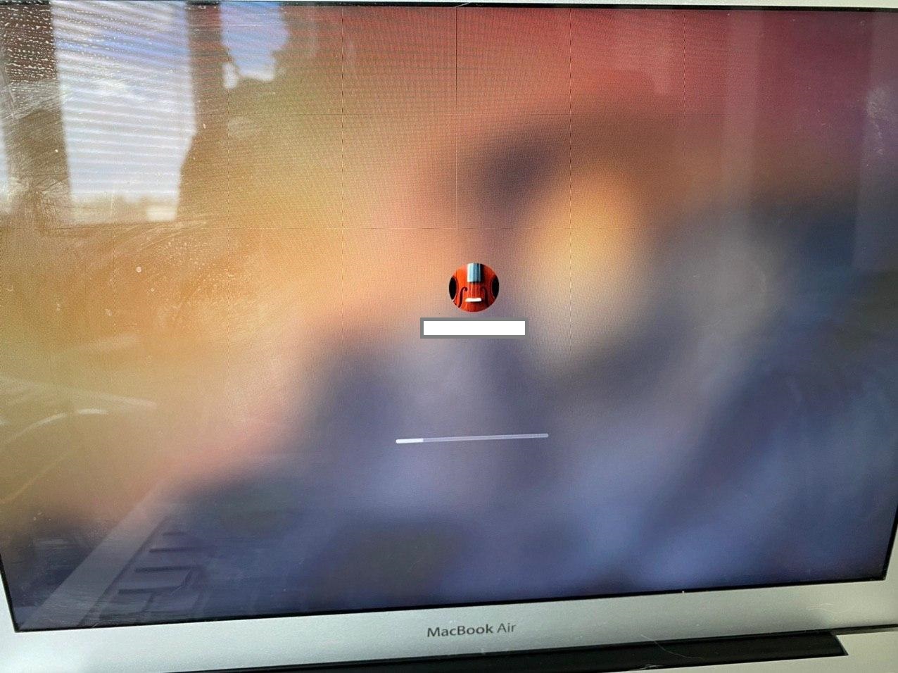

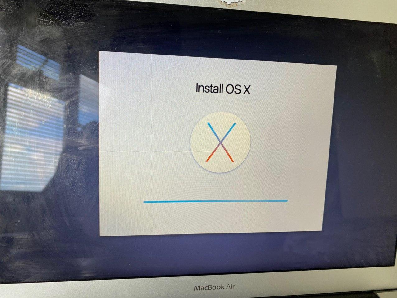

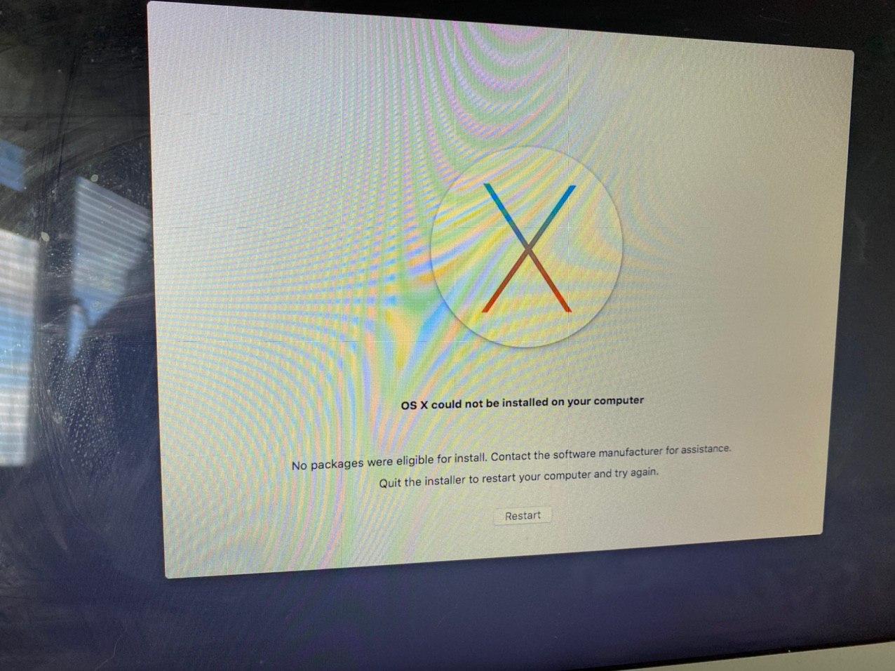

I don't know what has happened, but today I tried to log into my Mac, and it wouldn't let me in, kept giving error, so I tried to update it via USB, since then it's given me an error, and it just keeps telling me to contact the manufacture. I searched online, and found someone mentioning recovery via the internet, so I used the Option, Command and R for recovery now it's downloaded the OS install files, though I've come to another problem I have run out of disk space, is there any way for me to delete the internet recovery and Install the Mac OS X off the USB?
Or have I just lost all my files?
I've literally tried everything I could think off, Please help! I don't want to lose any of my files! If you need any more info on this please let me know, so can provide.

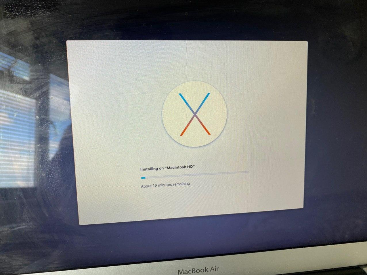

Well now, it's just looped into installing MAC OS X, but I tried to use the internet recovery, though it's downloaded the files, I've now got no space to install the files that are it's downloaded through internet recovery.
I don't know what else I can do. Is there any way to save my files?
[automerge]1592048539[/automerge]
Is there any way I can make space, without booting into the OS? As I am unable to do this.

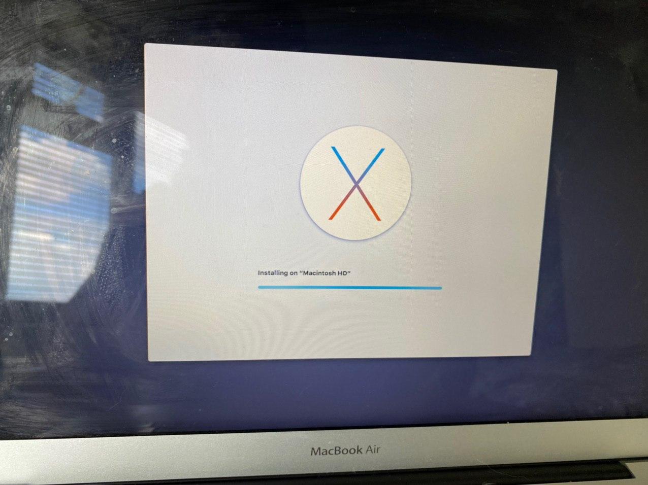

When I try to normally just boot it up, after inserting the password, it takes me to this installing Macintosh HD, later giving me the error.
And just loops, after inserting the password. I urgently need to access my files, and I can't seem to find anything online to aid. Stuck in a bad one here guys, all help would be greatly appreciated.
It seems the certificate expired problem. Boot from usb installer and change date in terminal to some date in 2018 and don't connect to the internet until it finishes installation.
If you have access to another Mac download El Capitan from here:
and create a new USB installer
