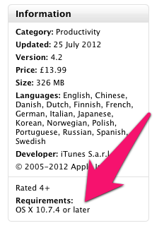

That's the Mac App store generally, current versions of iWork in the Mac App Store require 10.7.4
Snapshot 01:11:2012 17:16.png
Screenshot is requirements from current version of Pages in Mac App Store.
