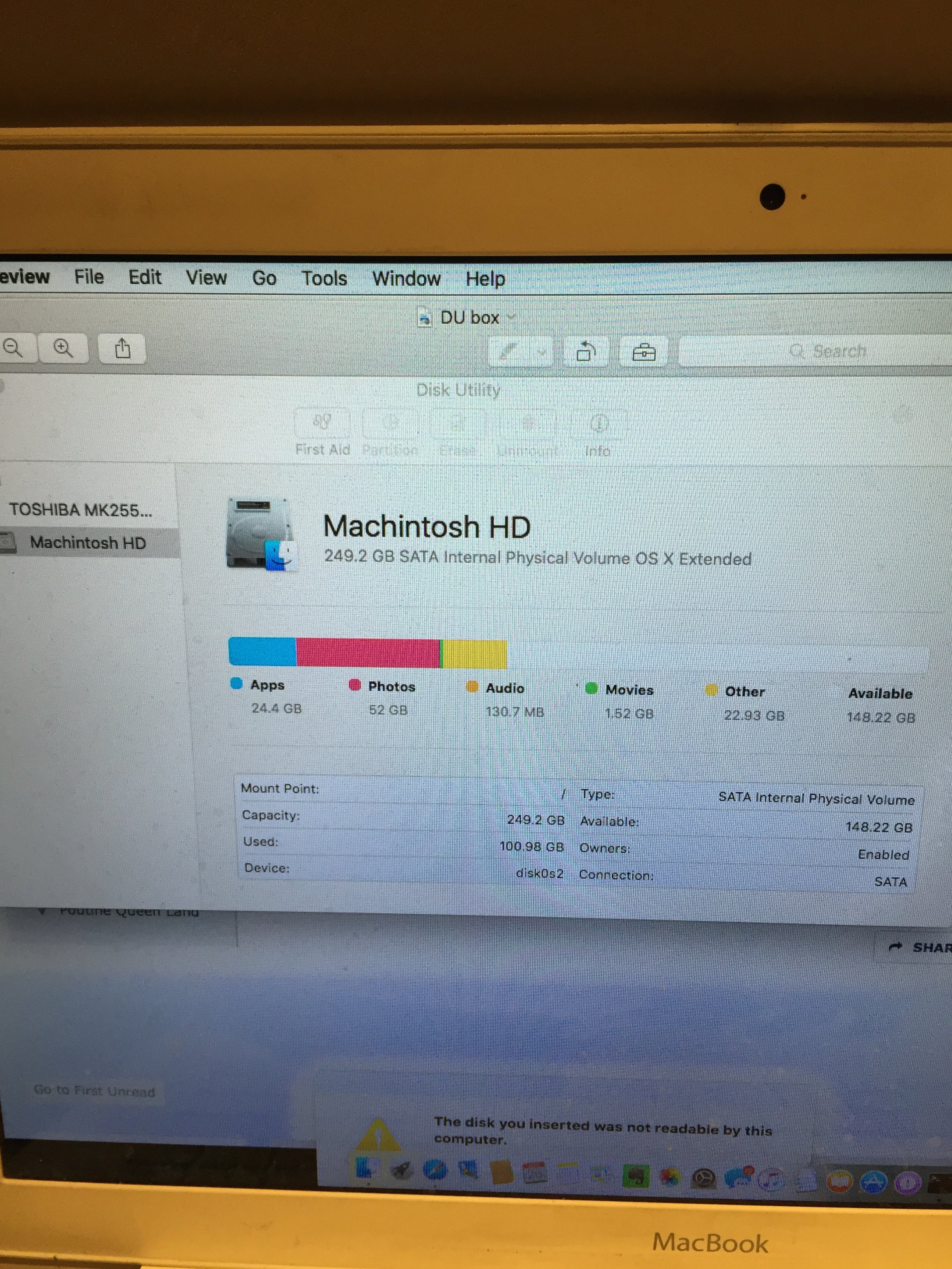

Mind posting a picture of the DU while the SSD is plugged in to make sure you aren't missing anything?
If your SSD is detected, it means everything's fine, but it isn't formatted. In your case, if the SSD is only partially detected (you can't mount it), then it is most likely something either with the drive or the enclosure you're using. I don't know what enclosure you're using, but those cheap Chinese ones tend to have problems.
The enclosure appears to be a brand from France.
The screenshot is attached.

Alright, works now. I would naturally try jiggling the connectors, trying different ports, just to be sure. Do you have any other hard drive to put inside the enclosure? If you can, try finding a different computer to try it on, or try a different enclosure.
