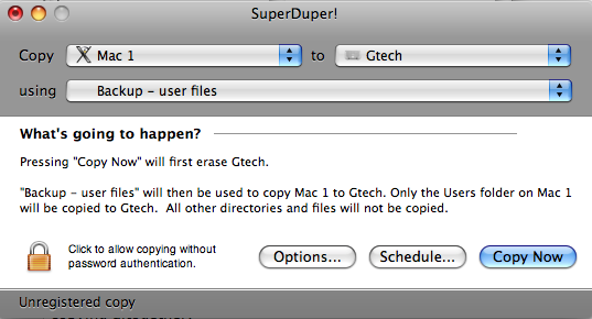

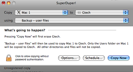

Edit Again: Below a screenshot of SuperDuper, Disk on left is Source(Boot Volume and disk on right is target(GTech) and below choose backup user files.
You probably do not need to create an empty home folder on the backup, the program will probably do so if there is no home folder on the backup, give it a try.
Be aware it might erase the disk, it says so.
Also, I myself prefer Synchronize! Pro X, there is a simpler version available (Synchronize! X Plus), free trail available.
