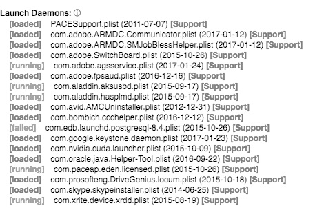

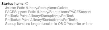

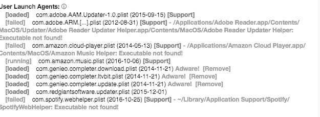

Thank you for recommending Etrecheck, Weaselboy. I ran it and found these things in red (though they show up as gray colored in the screen grabs).
The adware surprised me, but they're all rather old so I don't think they're the culprit.
I'll delete the stuff that's out of date/not compatible anymore.
I don't know what the "configuration files" thing is, but it was red and I don't know how to fix that.
In "Launch Daemons" there's a failed plist postgresql that looks suspicious. If that's the bug, then how would I fix that? Just delete and restart?
I'll delete the stuff that's not working and see if Finder improves.

I would go to /Library/StartupItems and remove everything there, as that startup method is no longer supported.
Then start removing things from ~/Library/LaunchAgents (~ is your users folder).

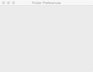

Well, I've done all the things you listed and Finder seems to improve some but still not able to move a file to a folder. Finder preferences window is all grayed out.
