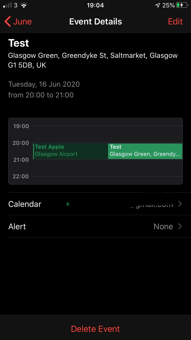

Thanks for your reply. I’ve just done another test. If I create a new event in Google Calendar, the location works properly and will launch Google Maps. If I then go to the event in the Apple Calendar app it will show the location address under the event title BUT it is not clickable. There’s also no map at the bottom of the page. Like so:

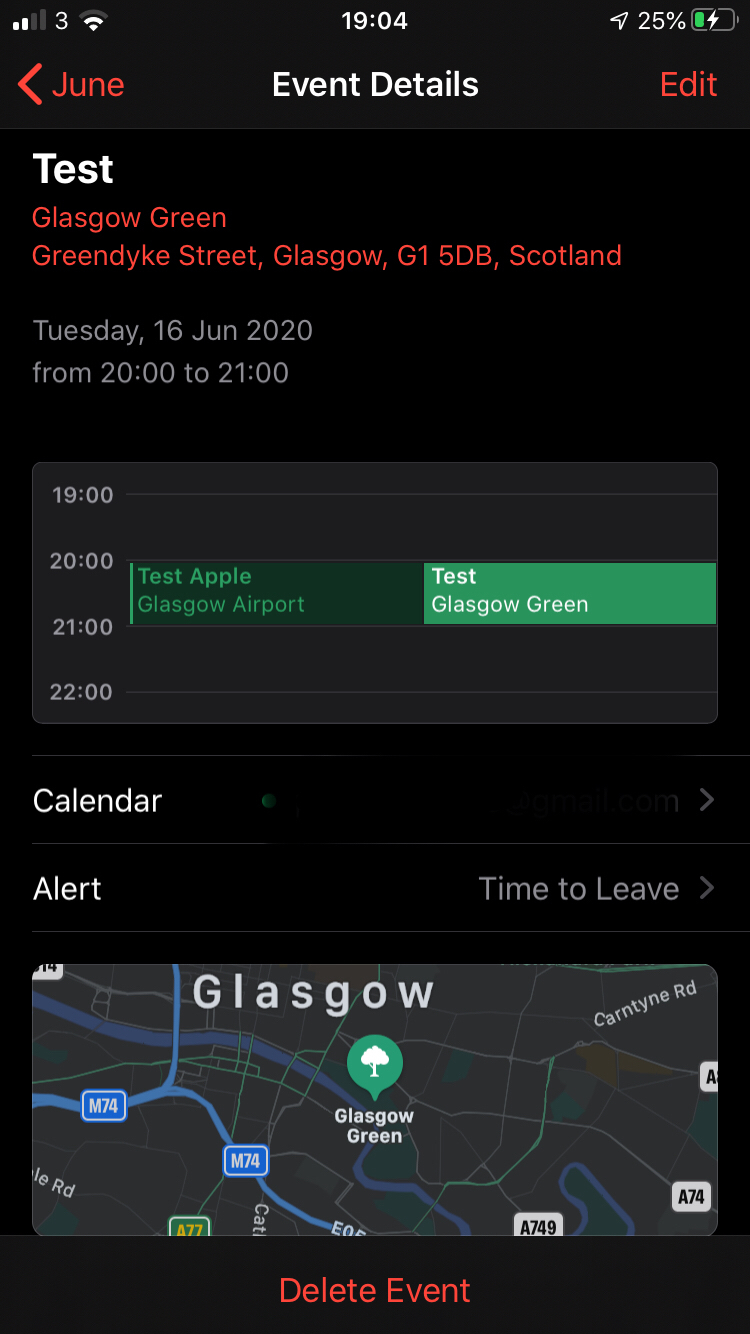

If I create an event using Apple Calendar app it will work as expected, I.e. when I start to type an address it suggests locations for me to select, I pick one and it then has the location in red and the map at the bottom of the screen. If I then go to Google Calendar the location works fine in there and will launch G Maps.

I use Google Calendar with the Calendar app, i've noticed that when i enter something and save it via the Google Calendar website if i put the address in there then it doesnt work, if i save it then edit it on my iPhone\iPad to enter the address then it works fine.
Its almost like the format that its saved in Google Calendar doesnt work with Calendar. I use the same function with CarPlay like you do to choose events in the Calendar app on CarPlay and then navigate to the address so it is annoying. I've just got into the habit of only adding the address for entries on the iPhone.

Still doesnt work for me. I added an event via the Google Calendar website and added a location in there by typing and selecting the location from the search box that shows. Checked on my phone and its got the full address but its not clickable and no map shows on the calendar entry. Also does the same if i copy and paste a full address in there rather than selecting from the search box that Google Calendar website shows.
