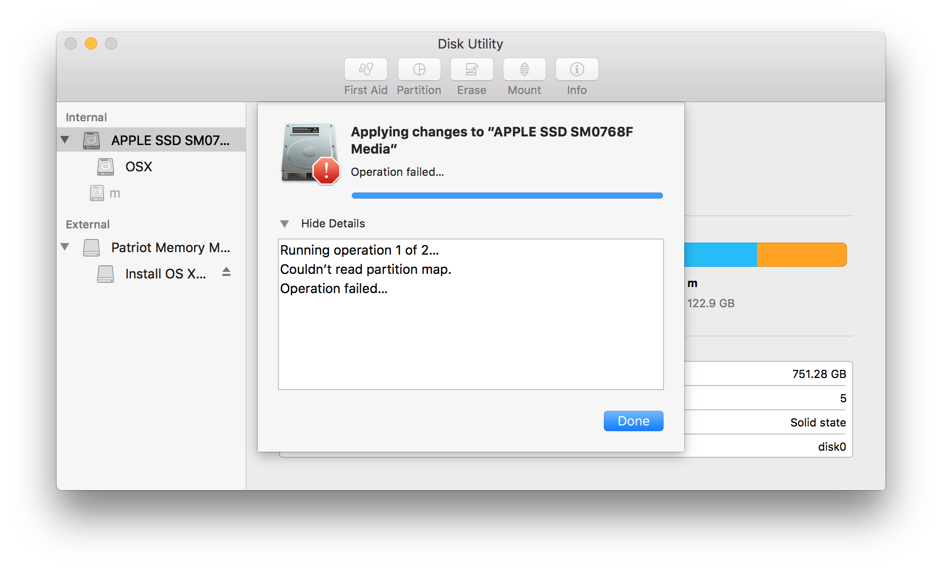

I'm trying to remove a partition and get back my drive, but i keep getting this error. Thoughts?

Are you booted to that Patriot USB key?
Open Terminal and run the two commands below then tell me the output of each.
Which one are you trying to get rid of?

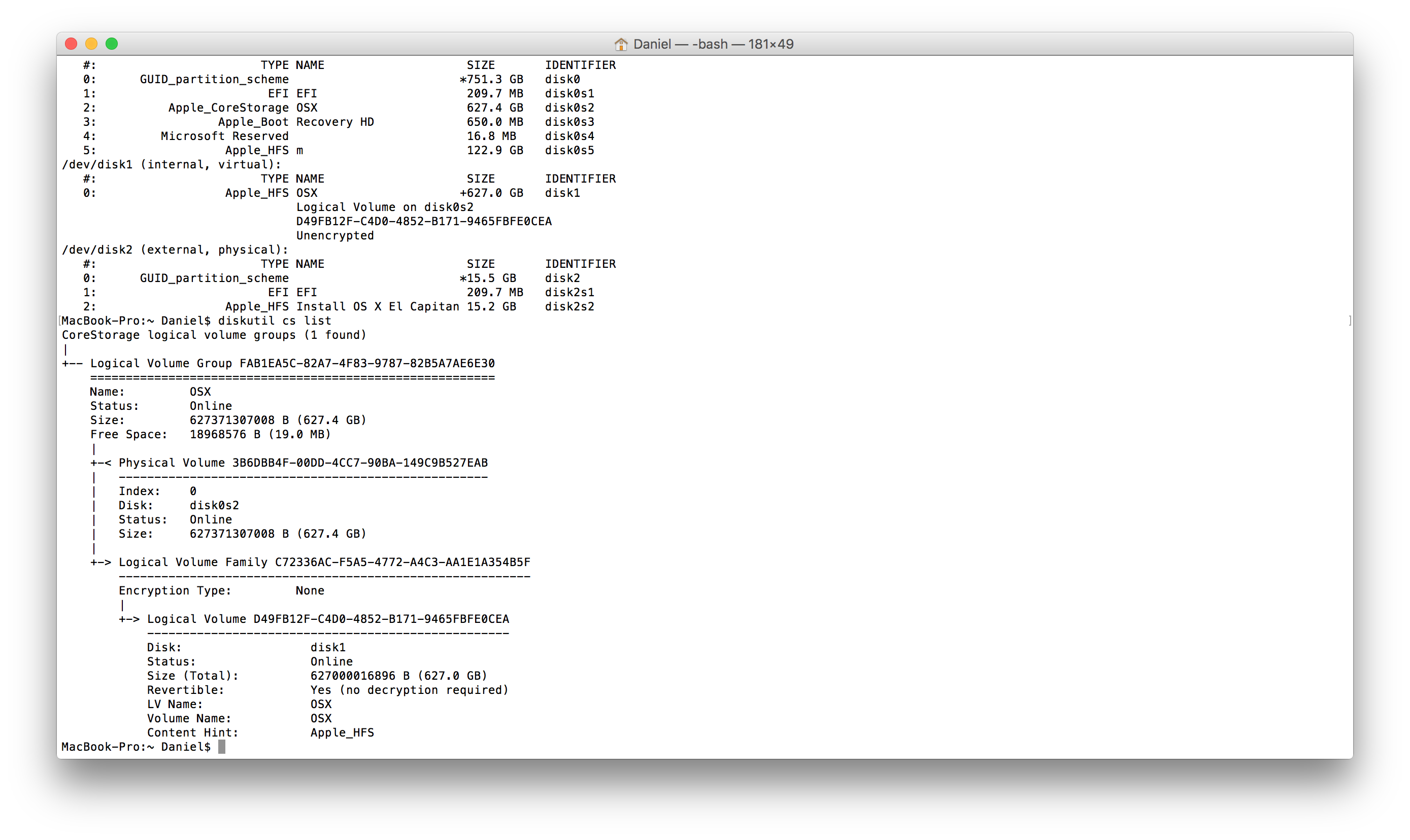

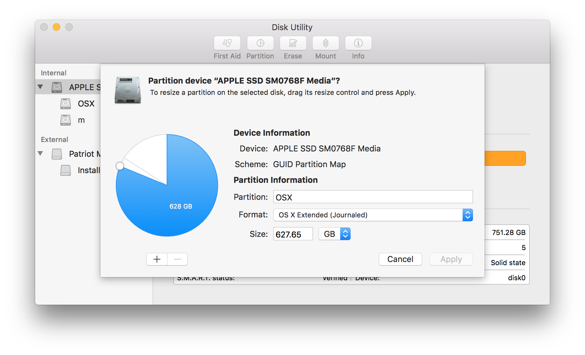

It was a boot camp partition, i didn't get rid of it the right way. No i did not boot into the drive. I'm trying get rid of the two smaller partitions seen in the picture below.

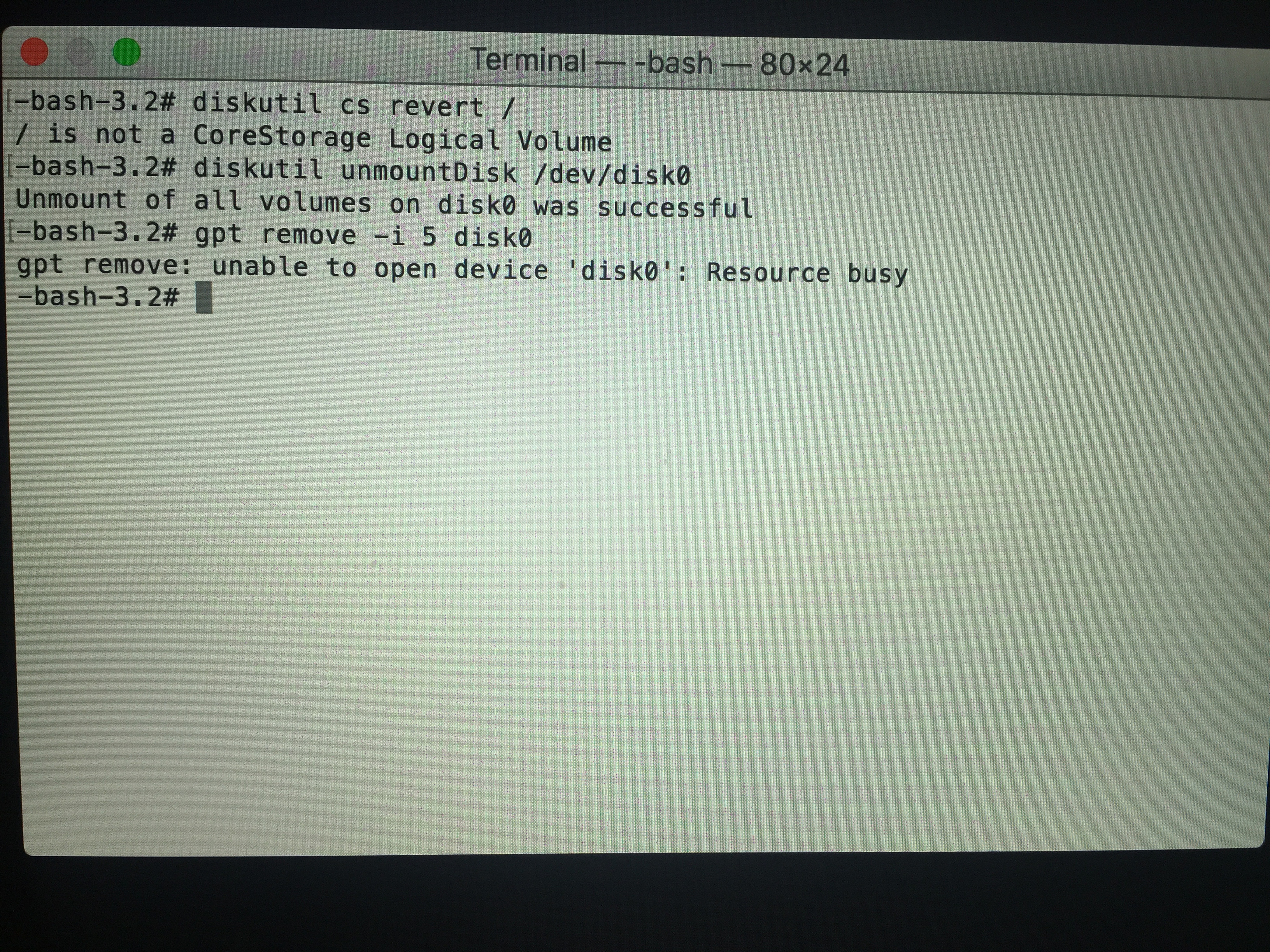

Thanks for the info, i booted to the installer usb i created, but this is what i get. Thoughts?

Hmm... do you need the data on the disk? Can we just wipe the whole drive and start over?
If so, run this in Terminal while booted from the recovery key.
Code:
diskutil cs delete "OSX"
That will wipe the OS partition. Then go to Terminal and in the erase tab select the disk itself at the top and format to Mac OS Extended (Journaled). That should get you back to a blank disk with one partition.
