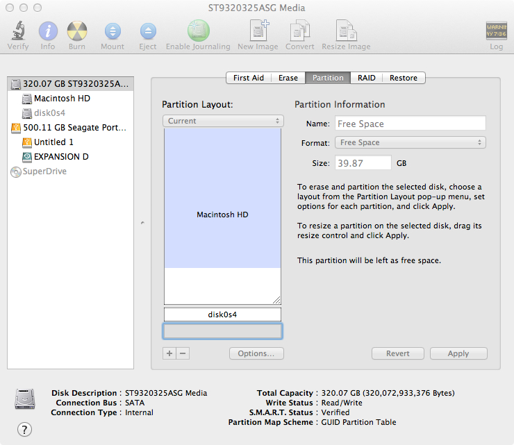

Then the interesting part. I open disk utility, select the 40gb partition which is free space, try to format it as ms-dos, but it gets stuck on preparing to partition disk. I have left it for hours, still hasn't done anything. Then I try to format it as Mac OS journaled, doesn't work, same thing. I reset the PRAM, doesn't work. Now, when I boot up it goes to the windows recovery partition, even though I have the windows partition as free space.

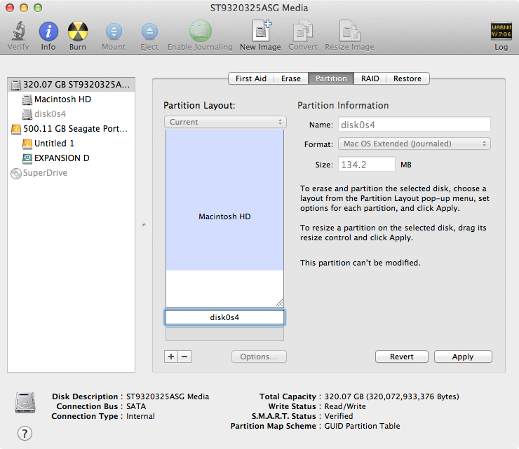

I don't know what that partition is. I think its the recovery hd, but i thought it was bigger
Sorry, it is only 100+ MB, forgot to look at it, it's likely the EFI partition, you don't seem to have a recovery HD, don't see it in the screenshot.

the free space at the bottom, I am unable to format
There is no free space partition, you have two partitions, one EFI and your Macintosh HD with OS X.
But, if you want to create an extra partition for installing windows onto you need to hit the + button under the Partition settings, that should do the trick.

there is a box underneath disk0s4.
It used to be my windows partition, I want to delete it and have 40gb more in macintosh hd

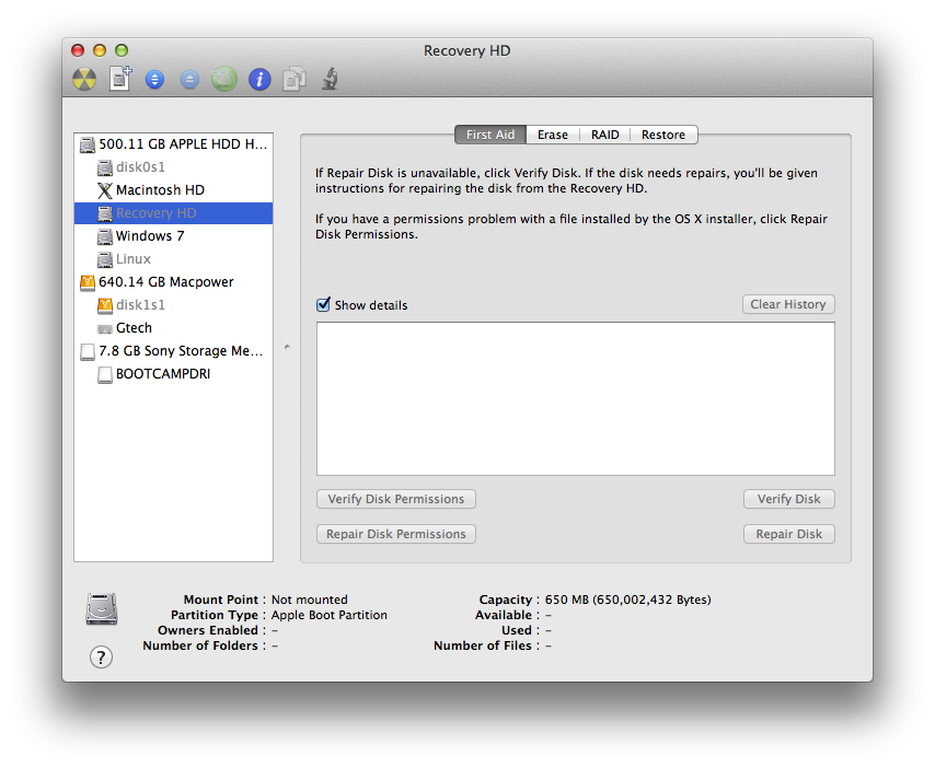

If that is the case yours should show up in Disk Utility, it clearly shows invisible disks like disk0s4, so it should show up.
See my screenshot, mine is clearly visible.
Don't mix up internet recovery and Recovery, they are different.
Is this the one where you hold down command-r?
Yes it is!
You can also see it's about 650 MB, that is the normal size for recovery HD.

Doing diskutil list, it says its a microsoft recovery.
There is no mention of a 40gb drive, which is how much free space i have.
