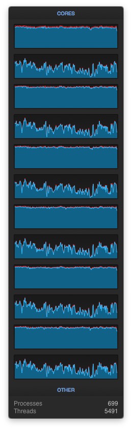

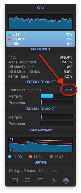

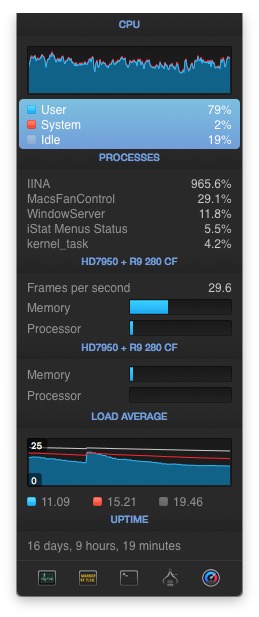

I just made a quick test on 4K H265 60Mbps play back on my cMP with IINA (this is the best 4K H265 player on my machine so far, but for some videos, MplayerX do better job). 1st few seconds choppy most likely I am encoding video as well. But once I pause the encoding, wait few seconds to let everything settle down. IINA can gives me smooth playback.
Anyway, this is the CPU usage. I played it for few minutes, the whole CPU history graph is valid for this test. The reading vary between 600-1000%.

It's possible that you are CPU limiting. However, 1000% on W3690 is roughly equals to 800% on E5-1620. So, I think your nMP should able to do that.

CPU usage was about 900% in IINA, and only about 500% in MplayerX. RAM is not limiting, SSD / HDD speed is also not limiting. So, the biggest suspect will be the CPU speed. My understanding is that even though the player is multi thread, CPU speed can still cause the shuttering.
I just tested it with IINA and was able to get 30fps on my hackintosh with i7 6700K clocked at 4.8GHz. CPU usage was ranging between 300-500%, mostly around 400%, from 8 threads. I suspect that per core GHz is the determining factor in getting this video to play smoothly.
