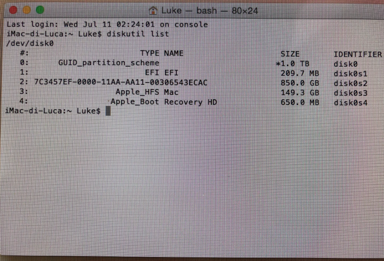

So I installed Yosemite, I checked how was my disk using diskutil list and the situation was as below:

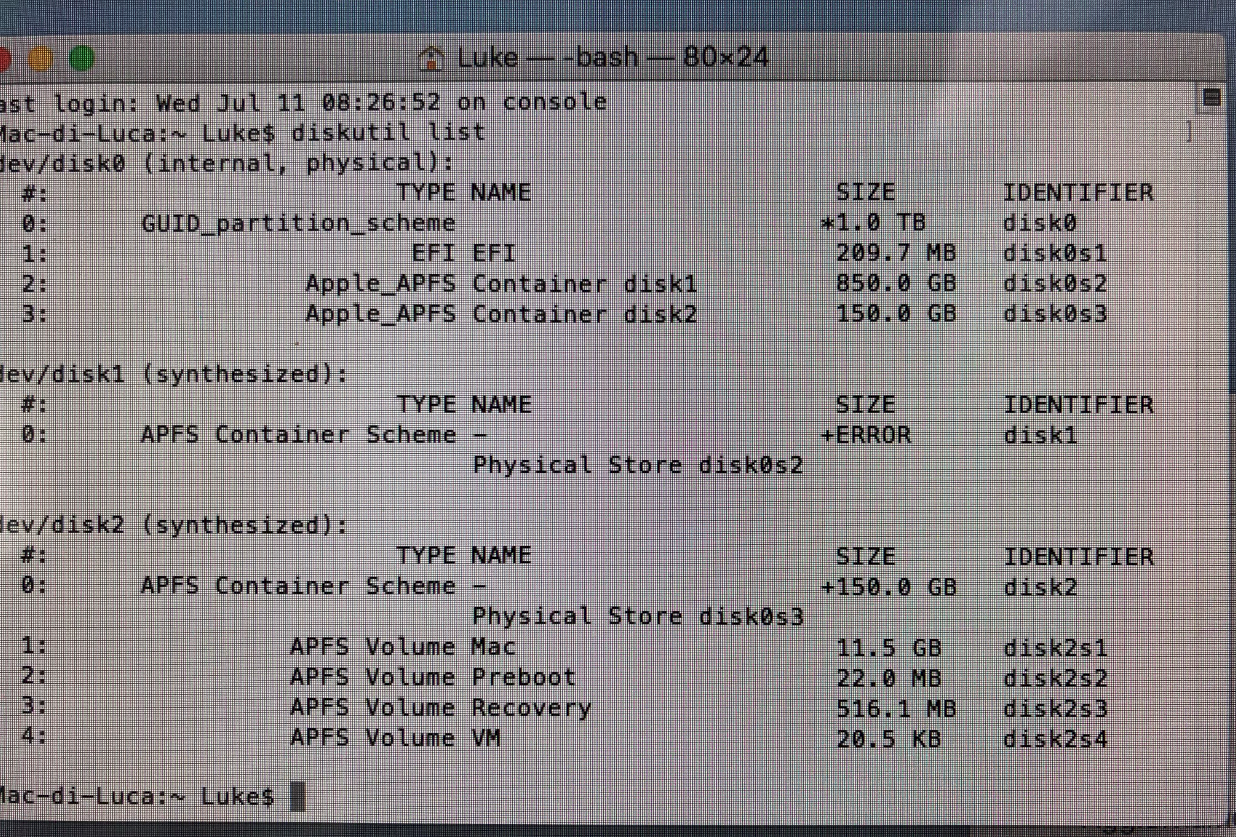

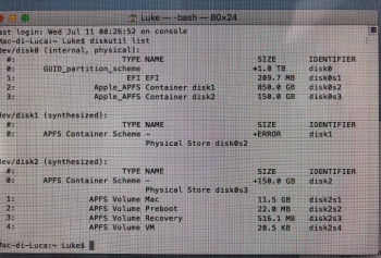

I then updated to High Sierra in order to have full access to APFS partition and the situation using diskutil list was as below:
disk0s2 is my main partition called "Macintosh HD"
disk0s3 it's my second partition called "Mac" that was originally partitioned for Ubuntu and now used for running High Sierra
As you can see, disk0s2 has a +ERROR in the container scheme. It seems like all data are there but no more recognizable. It seems to be a simple scheme error, but I don't know....
That partition is de-activated and there's no way to re-activate it. It's just greyed out in the Disk Utility, so it can't be used.
What do you suggest? How can I repair, fix or do something to that partition in order to access it again? I just resized it of 150 GB, damn it..... This new APFS file system is too fragile :-(
