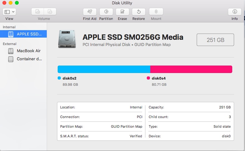

Hey, I signed up today and this is my very first post. I hope I'll get help; which I desperately need right now.

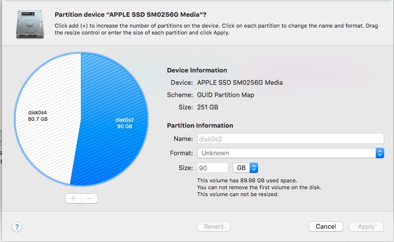

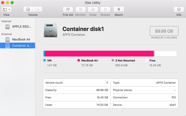

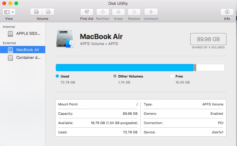

I just tried to uninstall and remove ubuntu from dual boot on Mac by just deleting the partition. Basically, I went to the 'Partition' tab and clicked both the partition and removed it. Now when I went to disk utility it seemed odd. It is showing the internal drive is divided into two sections and there are also two external drives namely MacBook Air and Container Disk.....
Did I do anything wrong? If yes, what should I do now it solve it?

Something's wrong - it could just be a bug in Disk Utility or something worse.
So what you should see (given the information you've presented) is "APPLE SSD ..." at the top level, and then "Container disk ..." indented below it (not under "External") and then "MacBook Air" below it and indented from "Container disk ...".
