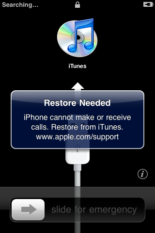

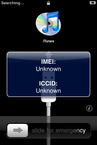

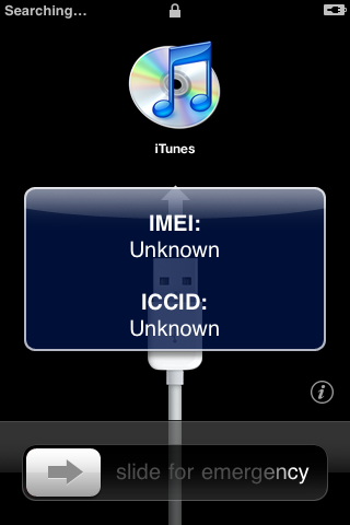

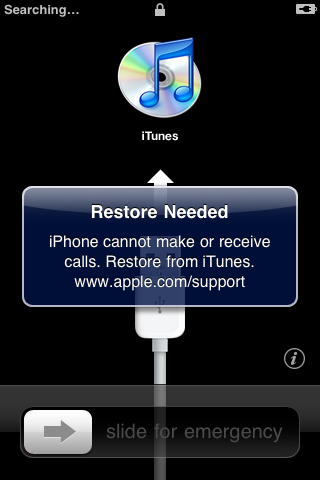

Figured out I can take screenshots and iPhoto shows my iPhone perfectly. This is the screen that I'm stuck with, along with showing no IMEI and ICCID.
