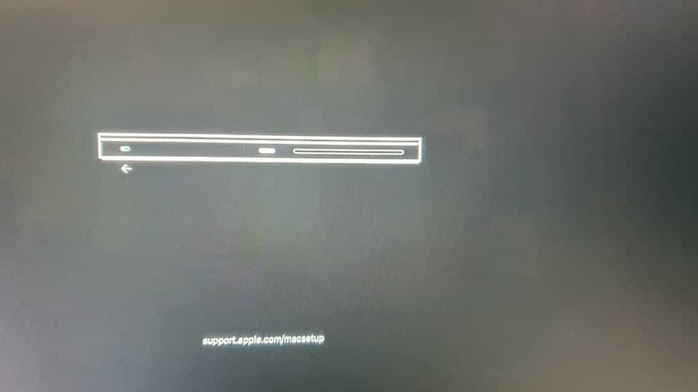

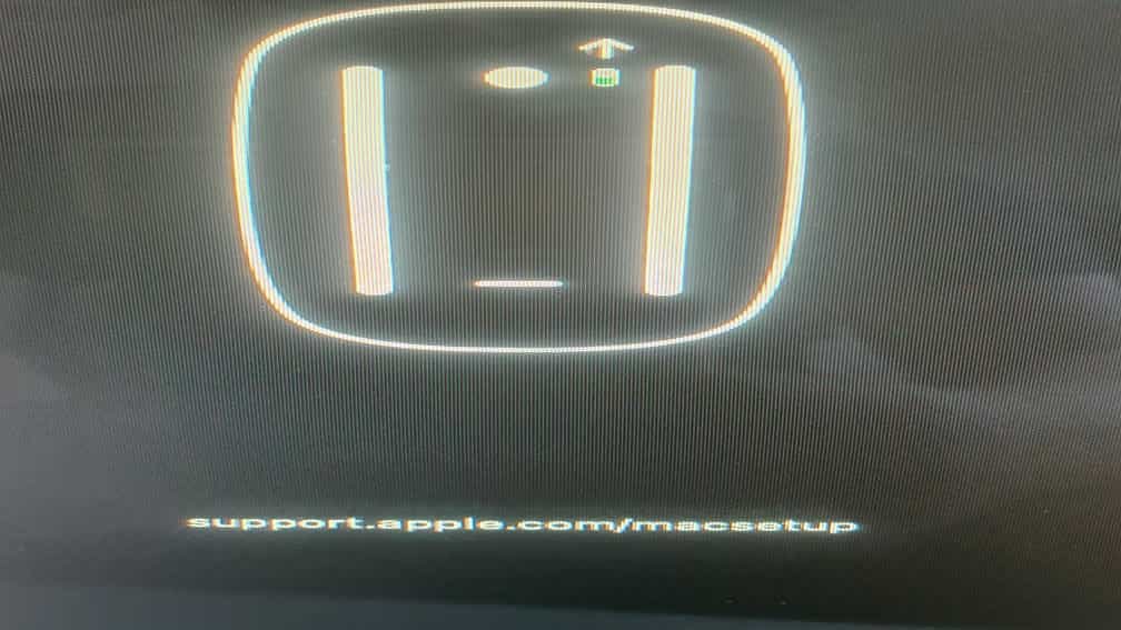

I have attempted, repeatedly, to boot from either the Sequoia or Sonoma USB bootable flash drive, selecting alt and the choosing the MacOS (not at the same time, the USBs are not attached to the USB ports at the same time ). I choose the EFI MacOS (Sequoia, say), it runs for a while and then I get an error message with 2 screens (which alternate) stating "support.apple.com/macsetup". I don't know what the 2 screens error messages mean.

I attach the photos with the errors.
Please advise what I can do to get either MacOS running. Thanks
These two screens are telling you to turn on the Magic Keyboard and Magic Mouse, meaning the installer isn't detecting any keyboards or mice connected to the Mac.
Not sure what keyboard and mouse you're using, but this is likely due to Ventura removing support for USB 1.1 drivers. There's a note about this linked on OCLP's site, and a workaround provided (use a USB 2.0 hub to plug your keyboard and mouse into).

Thank you for your reply. Using a Windows keyboard and and blutooth mouse. Will get the original keyboard and mouse shortly. Maybe this explains it.
