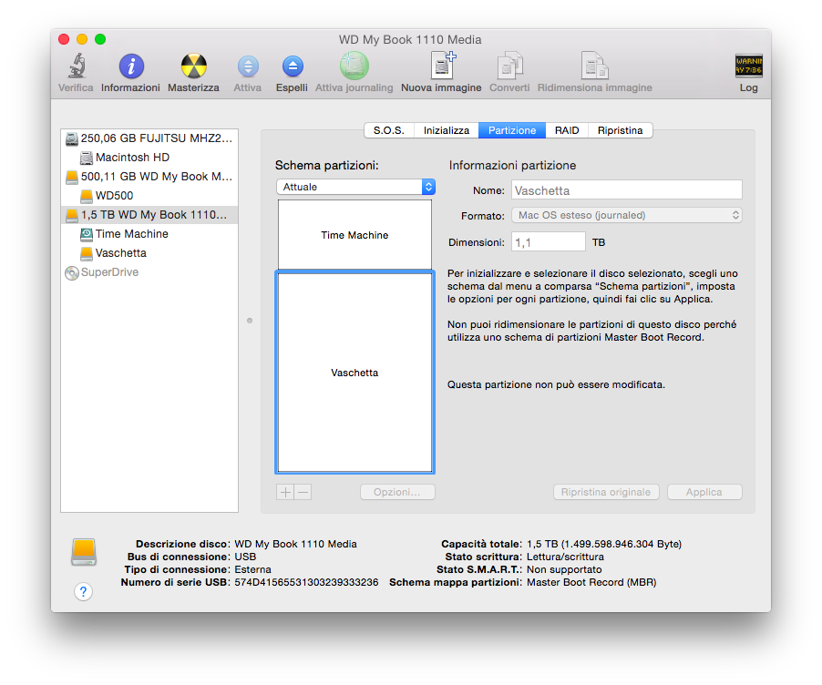

Can you open Disk Util and select your partition and post a screenshot of that?

I partitioned my disk a long time ago (2 or 3 years) so i can't now remember if i changed from GUID to MBR for some reason (maybe to have a NTFS disk.. but I don't remember why..)
Here's a screen.. and yes.. it's a MBR..
Yeah... you did put in MBR for some reason and that is the problem. You will need to reformat to GUID if you want to resize and that of course will erase any data on there.
