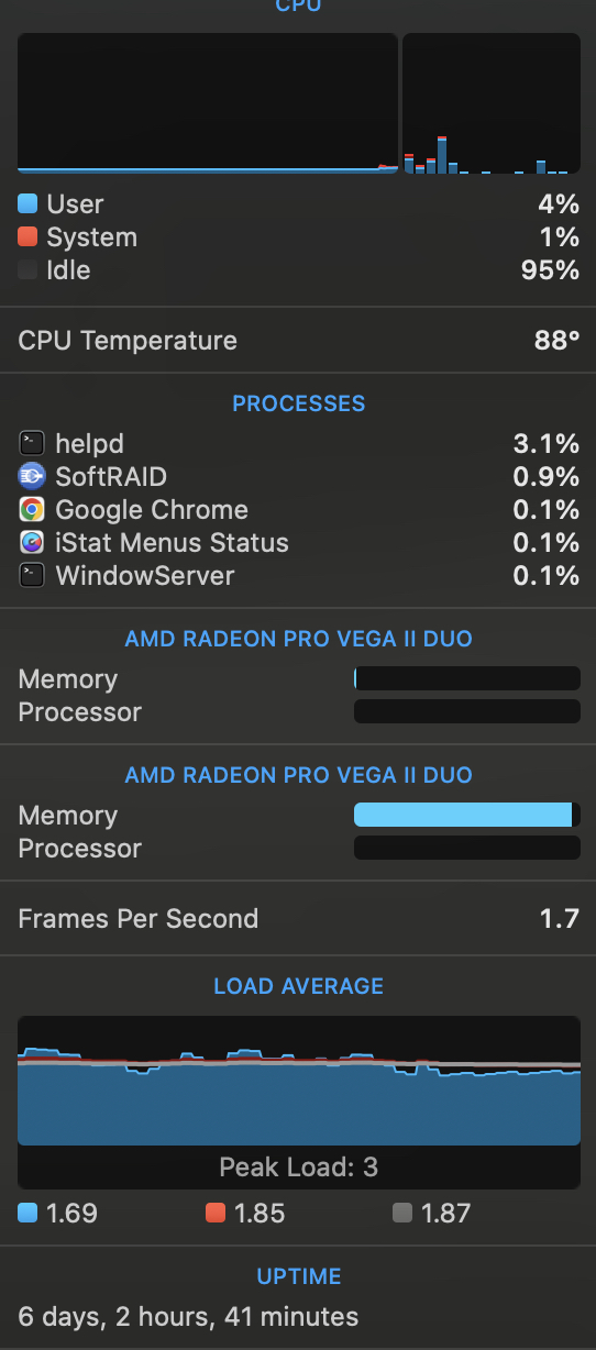

One last random note that is likely unrelated...... I have iStat monitors and it says that my AMD Radeon Pro Vega II Duo one of the cards is running at 95% on the memory, the processor is at zero on that card and the other card says its at 0 on both as seen below. Why is this?
I suspect that the intensity of the disk operations are the culprit. I've seen this behavior with similar intense disk activity. In ten days your mouse will be normal again.
