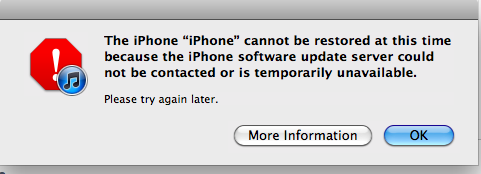

I successfully did the jailbreak on iPhone 4 and then tried to do a restore. iTunes wouldn't restore saying the server couldn't be contacted and to try later. Now I'm stuck in DFU mode. I can't restore thru iTunes and I can't boot the phone (stuck on the cable connecting to the old iTunes logo screen).
Any idea on how I can bail myself out?
Here is iTunes error message:

Thanks for the info.
I was able to restore using a Windows laptop. I installed iTunes 10, restored the iPhone 4, took it back to my Mac and restored that backup file and apps. Working ok now.

same thing is happening to me, I think its because I edited my host files a while back when restoring 4.0.1.... Have you ever edited yours?
I edited mine as well. Apparently tiny umbrella does something to ur host file so that on a restore it points iTunes to Cydia and not apple.

Happened to me too. It had nothing to do with the hosts file though. After the restore it was stuck at the emergency call screen and itunes wouldn't detect it. I got it into 'connect to itunes' mode and used tiny umbrella to get it out of that. The restore went off fine after that.
Exactly, you used TU. tiny umbrella writes to your host file. It had everything to do with your host file. You had to use TU to kick out. Because your host file is pointing itunes to cydia for the required info. TU makes that change. You will always have the issue when restoring. By editting the host file you are letting Itunes point back to apple. Thats why people are being able to restore. People that don't edit, can use TU to kick out of restore errors.
