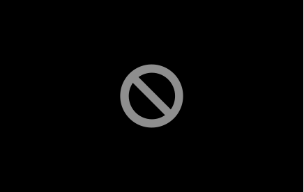

I can't restore or clone it from my ccc or even usb ps sorta.
anyone help please...
Your iMac 2017 has a special build of macOS 10.12.5 (Kaby Lake support). You cannot use a macOS 10.12.5 volume cloned from another Mac.
Wait until 10.12.6 update is released, or use the apple migration assistant.
Hello can someone help me with the problem below?
I've disconnected the fusion drive in my new 2017 iMac, but now it's impossible to reinstall Sierra. I've tried an external drive and try to boot with a USB drive, but every time the banned sign is on the screen. I can start via internet in recovery modes and perform tasks but without any result! Is there a special version of Sierra for the 2017 iMac?

I tried white a External boot disk but it didn't work and tried to instal whit a other MacBook via thunderbolt in targeted modes.
So you are going to have Apple replace the only the HDD, and you will be left with the existing 128GB flash drive, plus a 2TB flash drive Apple is going to install??
I think the issue here is as mentioned earlier, the new iMacs like yours likely use a special build of Sierra that you do not have on your other Macs or your USB key.
Try holding command-option-r (all three at once) when booting. Pick your wifi then you will see a spinning globe while the recovery utility downloads. Then you will see the recovery utility. From there use Disk Utility to erase the 128GB flash drive to Mac OS Extended (Journaled). Then quit Disk Util and click reinstall OS and point it to the 128GB flash drive.
That will get you up and running with the OS installed to the flash drive and the 2TB hard drive will be just sitting there unused. Then once you swap to the 2TB SSD you can either recreate the Fusion with that drive and the 128GB drive, or just use the 2TB SSD as a separate drive for storage.

Thanks for the tip, I had already started recovery via command-option-r and that worked, I've also reformatted the disks, but after that I tried to install with a usb drive, but not through the internet recovery (stupid of mine ) Tomorrow I'll try your tip (iMac is in my workplace) I'll let you know if it's successful. I am still in doubt to make a Fusion Drive or use the 128 GB as boot and program disk and the 2 TB as data disk. What would you recommend? The SSD I had from my old mac and an Apple service point enters the SSD into my iMac.

It works the imac is working again, I feel so stupid not to try it!
