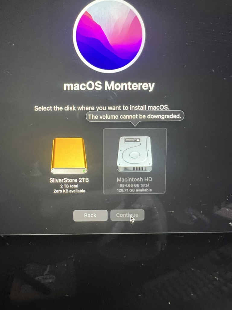

Hey everyone.
| am having a critical issue on my mac's sound:
VFF001
VFF002
VFF003
There may be an issue with the audio hardware.Contact Apple or take your computer to an AASP or Apple Store to learn which service and support options are available.
When I try to reinstall MacOS version in the recovery mode, this is what I see.
Can't proceed from there. Anyone seen this/

Are you trying to downgrade to Monterey from Ventura? If so I think you will need to erase, install Monterey and migrate from a TM or other backup. Some sites say the backup you use needs to be made while Monterey but that wasn't my experience when I tried it. A TM backup of a Ventura install was successfully migrated into Monterey.
Not sure what your problem is, or whether reinstalling Monterey or Ventura would help. With that message I would be inclined to run Apple Diagnostics which will report on the hardware....or do what it says and contact Apple.
I'm not trying to downgrade.
I am pressing down the power button and booting into recovery mode. I use recovery mode to try to reinstall macos. IDK why it gives the downgrade message this is not what I am trying to do.

What OS are you in? That screenshot says you are about to install Monterey.
As I said I would run Apple Diagnostics since you are being alerted to a possible hardware fault. And contact Apple.

I am not trying to downgrade. I just want to reinstall macOS through the recovery mode.

I'm in the recovery mode.
The issue started not after upgrade. But I want to try to fix before going to apple, I can't afford to spend money right now.

OK but then your installed OS is Monterey....if that is the screen you see when you boot to Recovery > Reinstall macOS.
Any special reason you haven't updated to Ventura? Unless your Mac is limited to Monterey by age, upgrading to Ventura would reinstall macOS and maybe Ventura will have fix if it is a software problem....which I doubt.
I think it a long shot that either reinstalling Monterey or Ventura will fix your problem, but could be wrong.

I'm on Ventura 13.2

Weird that screen says Monterey.

That is weird. In your shoes I would make a bootable 13.2 installer and reinstall from that, but don't think it will fix your suspected hardware problems.

Bootable installer is a good idea.
I am on a M1 Macbook Pro 14
Once you’ve updated to aVentura, I don’t think you can go back to Monterey.
Got it. I take it this is an Intel machine. If so, it should have an internet recovery option. That would work I bet.
You should have the option to recover by (re-)installing Ventura. One of the options though is to reinstall using the version of MacOS that was originally shipped with your laptop, which is what you seem to be doing.

No he says above it is an M1 MBP14"
Reactions: adrianlondon
Then he has the option to boot to Fallback Recovery and try reinstalling from there!
Yes he could try that, quite tricky to get timing right when I tried it.
Since there seems to be something wrong with his primary Recovery (offering Monterey) my preference would be the bootable installer route which might fix main Recovery.
Fallback Recovery is last resort if it won't boot from primary Recovery but I doubt (might do) that it would fix main Recovery.

The OP has a MacBook Pro 14" (m-series Mac). However, he didn't tell us that until 'way down in the thread.
The old trick (on Intel) of "Command-shift-option-R" (to reinstall older OS) doesn't work any more.
All changed now.
What MIGHT work would be to download a copy of Ventura and create a bootable USB installer.
Then, boot from the USB installer, wipe the internal drive, install Ventura from there.
(I was able to create a bootable flash drive with Monterey, that will boot my MacBook Pro 14" -- but I HAVE NOT attempted to erase/install using it)
With Apple's "new way" and the m-series, looks like you can only go "upwards" (via Recovery), and no longer "back" (as the special key command above would let one do).
