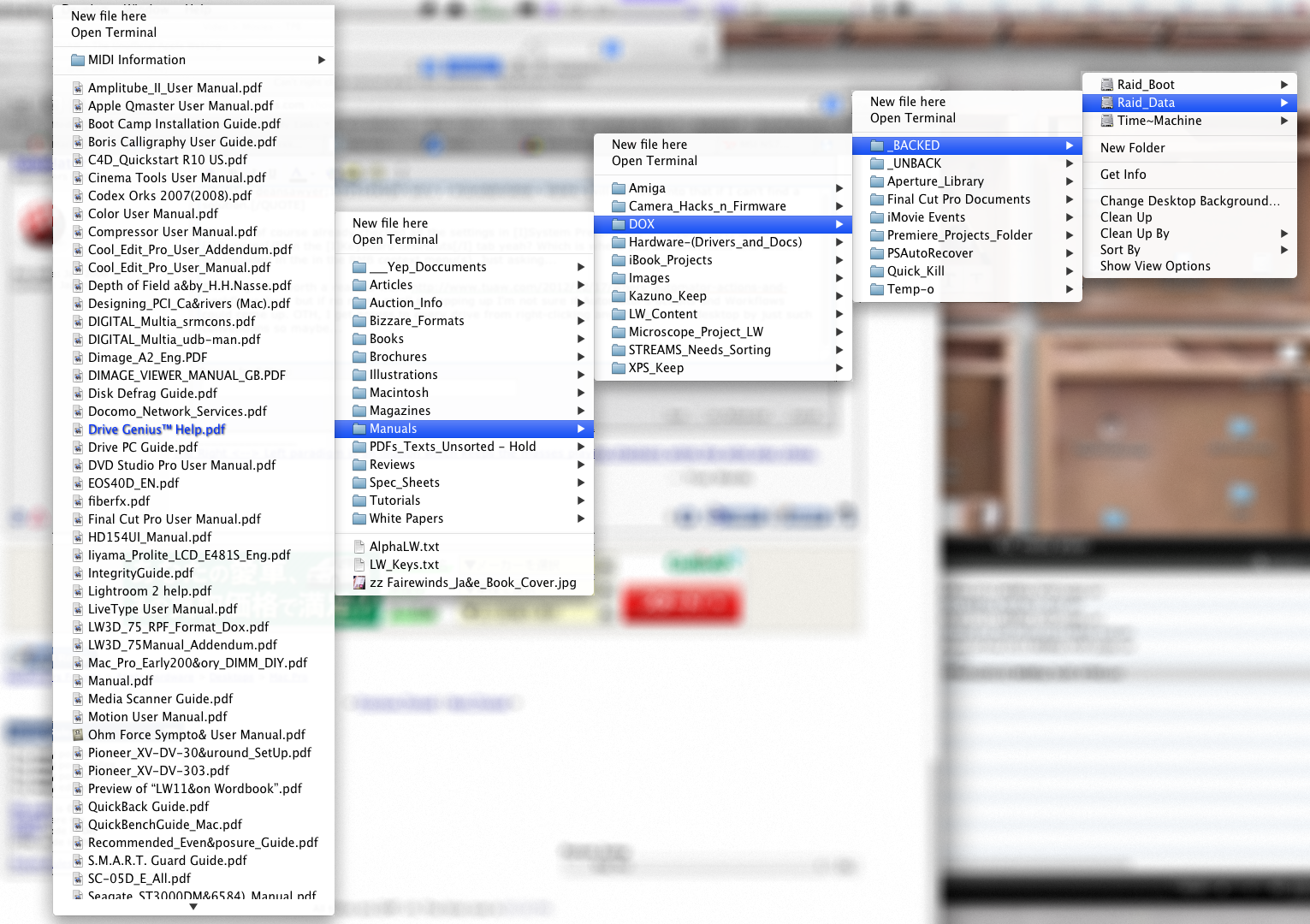

NP. You of course already checked all the settings in System Preferences > Keyboard under Services in the Keyboard Shortcuts tab yeah? Which is where you set what does and doesn't get included in the in the RMB context menu(s). Just asking...
This might be worth a read as well: http://www.tuaw.com/2012/12/17/where-automator-actions-and-workflows-live/ but if no menu at all is popping up I'm not sure if Automator's actions and Workflows could come up. OTH, I get access to every drive from right-clicking anywhere on the desktop by just such conventions so maybe...
